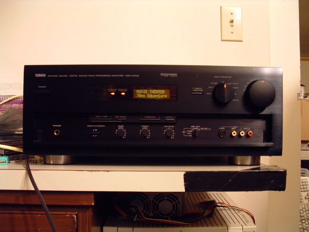

From the ancient sands of time... comes the millionth review of the Yamaha DSP-A1000 :p :D
Build Quality:
Coming from a near twenty year old piece of analogous bliss and state of the art design (when it was new), this receiver has held up exceptionally well over this period of time. It has a solid brush, anodized aluminum faceplate with white silkscreen lettering marking model number and control function designations, as well as a drop-down face plate made out of brushed and anodized aluminum. The chassis is made of zinc-plated stamped steel, while the top cover is zinc plated, with a baked powder paint for added durability and some internal foam dampening for added resonance reduction.

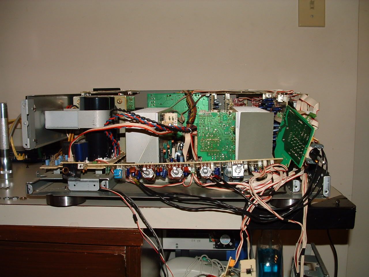

Internals:
Well, due to a recent hiccup in this device, I was forced to tear it down and make repairs to bring it back to perfect operating condition. I did well.... but also had about 3 hours of my life sucked away:

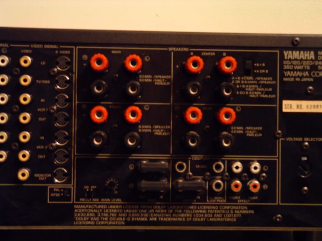

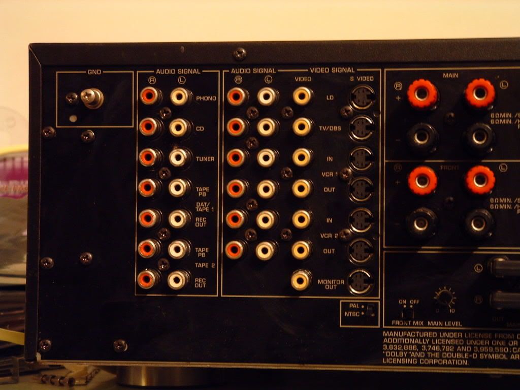

Inputs:
As you can see, there is quite a few inputs. I'm too lazy to list them, but the audio/video inputs are all there (except for pre-in/out, coupler, subwoofer, and a few other little ones.)

Thanx for the review, yettie. Great pics. I've never owned any Yamaha gear. I have worked in some homes for clients, (I'm a small contractor) who have had Yammies and the build quality was excellent(turning the volume knob is our version of kicking the tires, lol......) D2T

Nice innards...:) Decent sized caps there. Any idea what the rating is?

You took the poor thing apart!!! Pretty good build from what I can see. Have you done any measurements? Can it drive 4 ohm speakers with a 3 ohm min ?
I forget. I know each cap is the size of a Red Bull can :eek: It's going to be fun finding those when they die.
Yeah, it isn't as poor as it looks. No measurements, just use and comparison to other equipment. The PSB's I used to have, were not the easiest speakers in the world to power. I estimated those to be around 6 ohm nominal. It was loud enough without distortion to hurt your ears (but not make them bleed). Getting to ear bleeding volume introduced distortion.

You can use pretty much any receiver as a two-channel amplifier, and this one looks to be easy to use in that application. On the back panel, there are usually two bars that couple the pre-amp outputs for the main channels to the inputs for those channels. You'd take out those bars and plug your pre-amp outputs into the inputs on the DSP-A1000. Same appears to go for the center channel, so that's three channels. The jacks for the rears look like outputs, not inputs, but I don't know for sure.
