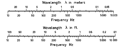

Consider the physical differences between the frequencies. A 10 Hz sound is ten times longer than a 100 Hz sound, which is 10 times longer than a 1000 Hz sound, etc. For every octave lower a woofer has to play, its excursion must increase four-fold. Consider how much space the subwoofer band eats up in this logarithmic scale of sound waves:
Keep in mind humans perceive sound in a logarithmic manner much more so than linear.
