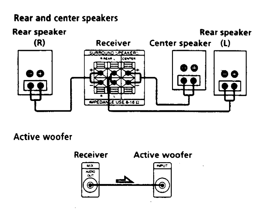

So from I could find, you’ll connect the “mix out” on the AVR to the right input on the subwoofer. Then you’ll have to use the controls on the sub to set the output level and low pass, since the Sony has no bass management. A modern receiver would connect using the left/lfe input and you’d then use the AVR’s bass management to to set the crossover(which is pretty much a low pass filter too), distance and auto eq etc.

Mix out looks to be your only option, though since the sub does not have speaker level inputs and the receiver doesn't have an actual sub preamp output.
Standard RCA cable that you can get anywhere if you don't have one laying around. The cable used for the CD player is the same thing, if you have one of those.

Just any old rca cable will do. If you’re anything like the rest of us you’ll probably have a few cables laying around.

Yeah, while labeled MIX OUT, the port is meant for an active woofer(powered sub.)

My only question is, is that mix out volume controlled across all inputs? This was from the early prologic days when subs were not quite common yet and that output could be used by a variety of devices. Guessing it will be.

That is an older analog receiver with no bass management. I believe the pre out is volume controlled and is just summing the signal which is full range with no means of applying a crossover. So, manual adjustments must be made on the sub for low pass. Without digital ports supporting multichannel signals, there will be no digital processing other than limited Pro Logic processing.

The only thing I would add as that when one of the inputs on the subwoofer is labeled LFE, then you use that connection if using a single cord (Left input in this case). Either will usually work, though, as the L+R will be bridged for mono. It's a high impedance connection so you can also use a stereo cable with a Y-splitter at the receiver.

Actually I mentioned above to use the right input. The LFE/right input will bypass the subs internal XO/low pass. So definitely not the case that either will work since she’ll need to use the subs low pass.

Interesting. I've never come across any material that states that a particular input bypasses the XO/low pass filter but some forums state that some models do. The crossover dial is simply turned all the way up to bypass the filter on most. The Sunfire manual is pretty useless. It doesn't even show or describe how to connect it. The brochure describes the inputs as right and left and "dedicated LFE", so you could be right.

FWIW I've run into subs that the "lfe" input does not turn off the low pass filter...I was just looking at the useless start up guide from Sunfire, too. In this case, with the avr not having bass management, to be cautious I'd do like William suggested, tho.

You know, while the receiver does have volume level functions for the surround and center channels, there is no such feature for the fronts or MIX OUT. I'd err on the side of caution and assume a full range signal is fixed and is always output to the fronts and sub. This could spell doom for the fronts if a boyfriend and or his buddies decide to test the limits of the sub and not realize the fronts will reach their limit before it and be blown because they are getting a full signal equal to that of the sub.
I'd set the sub gain at 50% to start and the crossover at 80Hz. I'd also lower the bass level on the receiver. If at 0, try -2 or even -3. This will take a bit of the heat off of the fronts and lessen any bloat or muddy sounding bass if present. If blend is not quite right, turn things down a bit on the sub, maybe 35% gain and 60Hz crossover. The goal is improved bass at lower and medium volume rather than thunderous bass at very high levels which will ruin the front speakers.

Did you read the article on sub setup I linked earlier?
As far as the knobs on the sub go, I'd start with phase at 0 (but refer to the article too to test other settings)
The crossover in your case is just a low pass filter (to control how much frequency range your sub gets). and you basically want to find a balance between your speakers' low end capability and where you want the sub to blend in. What speakers are you using?
Setting levels for your speakers looks like you're limited to using the volume/gain adjustment on the sub to find a good balance of levels between your speakers and sub (at least it seems test tones and level adjustments do not include such for the sub from looking at the manual.....you can join up here and download the manual https://www.hifiengine.com/manual_library/sony/str-de605.shtml ). Perhaps an spl meter app on your phone might help.
As to the noises/heat, could be these components' old age, or simply playing too loud or somewhere in between....
