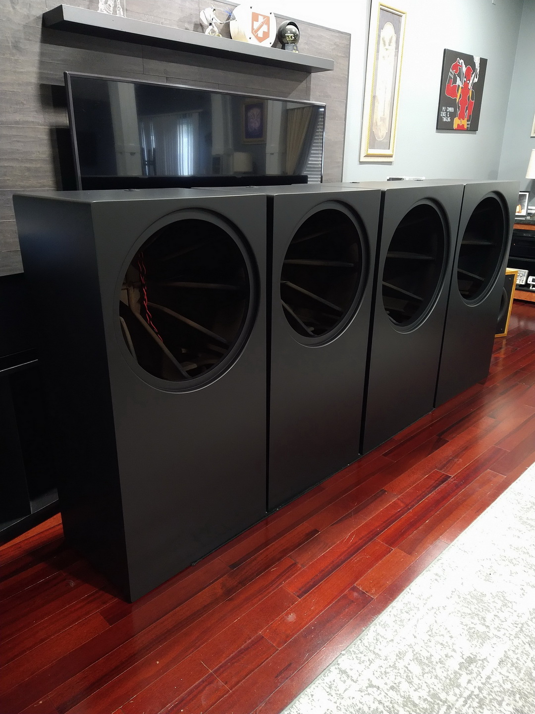

Just curious what it the current performance and bang for the buck designs. Is it still the VBSS and Marty Cubes?
ryanosaur
ryanosaur
A lot of folk like the Devastaor designs, if you have the space as they can be very large.
GSG’s offering are well liked, especially if you don’t want to buy raw sheet stock and do all the cutting, and again their AIY systems scratch many itches.
For Drivers, I think Harbottle is top of the heap. Old DataBass measurements show flawless compression sweeps and outstanding performance.
New buzz has been popping up for One Audio Drivers but I know very little about them beyond hearsay.
