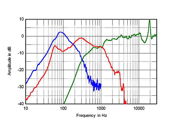

    Its too bad it has a lousy tweeter. Everything else looks A OK. However even though the break up in the tweeter is at the upper limits of hearing. I can always here those devils. The problem is retained energy and I suspect there is severe distortion heading into break up. You may not hear it on pop music, but you will on classical. That problem creates a sort of odd "swish" sound to the top end. It particularly makes cymbal crashes sound distinctly odd. That tweeter seems a particularly bad example of the breed. That was a mistake they could easily have avoided. Marketing I bet insisted on a shiny tweeter!

    yes, I reckon this looks like a pretty severe resonance

    Yes, it is severe. It is a nasty 15db up and downer and in the audio range. If you look carefully you can see it actually starts to misbehave at 6 to 7 KHz. The funny thing is about that problem on a quick listen it can add a sort of attractive shimmer to the top end. I can assure you the novelty will wear off. That was totally unnecessary as you can buy a tweeter that does not do that for less then $20. I would never ever select a tweeter that does that for any of my designs.
