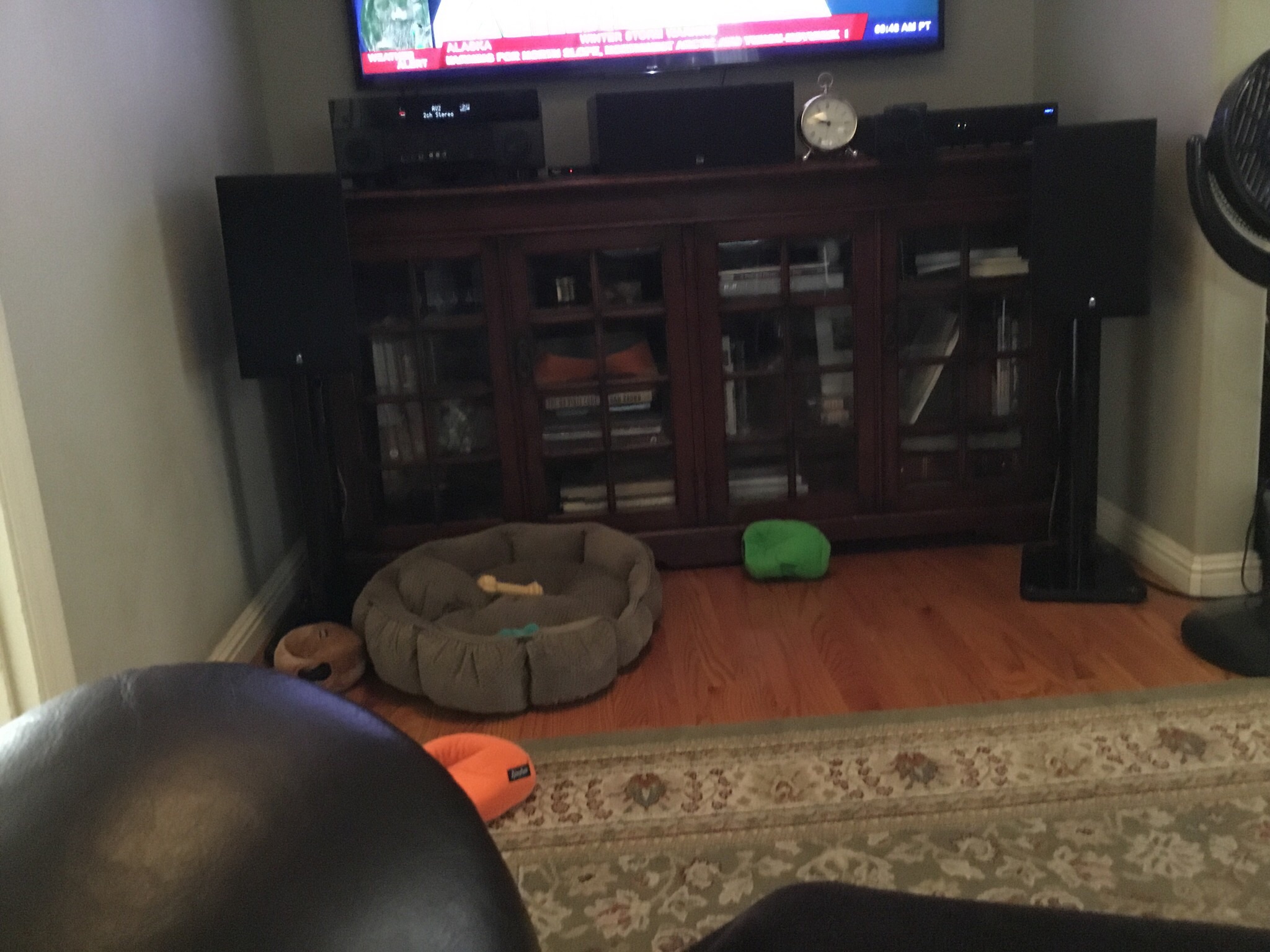

any suggestions to make dialogue better?

Good4it Audioholic Chief Aug 23, 2016 #6 I should have said more understandable. I've tried different speakers and still have problems understanding . Increasing volume is one way but there is a limit. Just looking for other, serious ways.

BoredSysAdmin Audioholic Slumlord Aug 23, 2016 #7 Good4it said: I should have said more understandable. I've tried different speakers and still have problems understanding . Increasing volume is one way but there is a limit. Just looking for other, serious ways. Click to expand... other ways, include re-running Auto-EQ, improving room acoustics and upgrading center speaker.

Good4it Audioholic Chief Aug 23, 2016 #8 Currently I'm using a BW 686 center positioned in the center (duh) at the same height as my front speakers which are 9ft from me. Upgrade to?

BoredSysAdmin Audioholic Slumlord Aug 23, 2016 #11 Move the center to match edge of credenza and try to insert rear port plug.

Good4it Audioholic Chief Aug 23, 2016 #13 Thanks for the suggestion I'll try that. Ps; dog uses them more than me.....if they were mine I wouldn't leave them on the floor Last edited: Aug 23, 2016

WaynePflughaupt Audioholic Samurai Aug 23, 2016 #14 If your receiver has dedicated EQ for the center channel, increase the siblings (+4 dB or so on the 6-7 kHz range) and /or reduce lower-end bloom (-4-6 dB on the 200 Hz range). Regards, Wayne A. Pflughaupt

S shadyJ Speaker of the House Staff member Aug 23, 2016 #15 It's possible that congested area around the speakers is making the off-axis response a larger factor than it would be otherwise, and that center speaker design does not have a very promising off-axis response. Refer to this post.

afterlife2 Audioholic Warlord Aug 23, 2016 #16 I would get rid of the grill too and point the tweeter towards ear. Put something underneath the center(try front or back) to point more in the ear.
