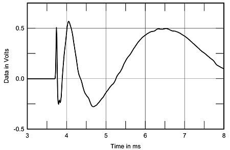

Time/domain performance of Revel Ultima Studio 2

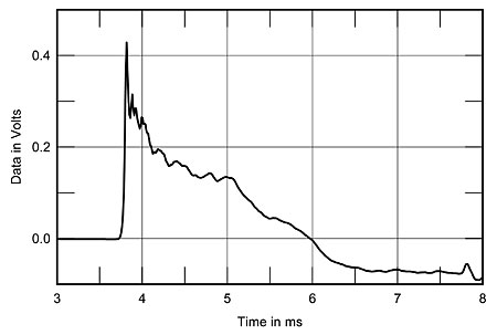

Time domain performance of Vandersteen 2 CE
Ideally this should be a triangle, clear to see which is superior in this sense :D
As a former fan of Dunlavy speakers, and a current owner of Salon 2s, I think these two graphs present an extremely interesting question. That question is, can the human brain differentiate between arrivals less than 3ms different in time? If you were to compress the x-axis on that graph it would show that the Studio 2 probably produces a more effective triangle than the 2CE does.
I never convinced myself to buy the Dunlavy SC-V, so I haven't directly compared the V to the Salon 2, my listening tests were in different rooms, and I'll be the first to admit that making audition comparisons, what, seven years apart, is lunacy. I spent well over eight hours listening to the SC-V (mostly because I couldn't really afford them at the time, so the decision process was quite lengthy), and I still use the same CDs for speaker auditioning. Lunacy aside...
I can say without any doubt in my mind that there's *nothing* an SC-V could do, realism-wise, that a Salon 2 can't. IMHO the SC-V was - is - a remarkable speaker and a remarkable accomplishment, but I'm at a loss to attribute any advantage to the time-coherent nature of the design. If John had stayed in business and lived I sincerely wonder what he could have accomplished with modern drivers like those from Seas, but time incoherent designs can produce absolutely enveloping imaging, and highs so realistic (like when reproducing cymbals) that I'm not sure I could choose the real thing blind-folded.
So if it isn't imaging and sounding "live", what are these supposed advantages that only time coherent designs can provide?
