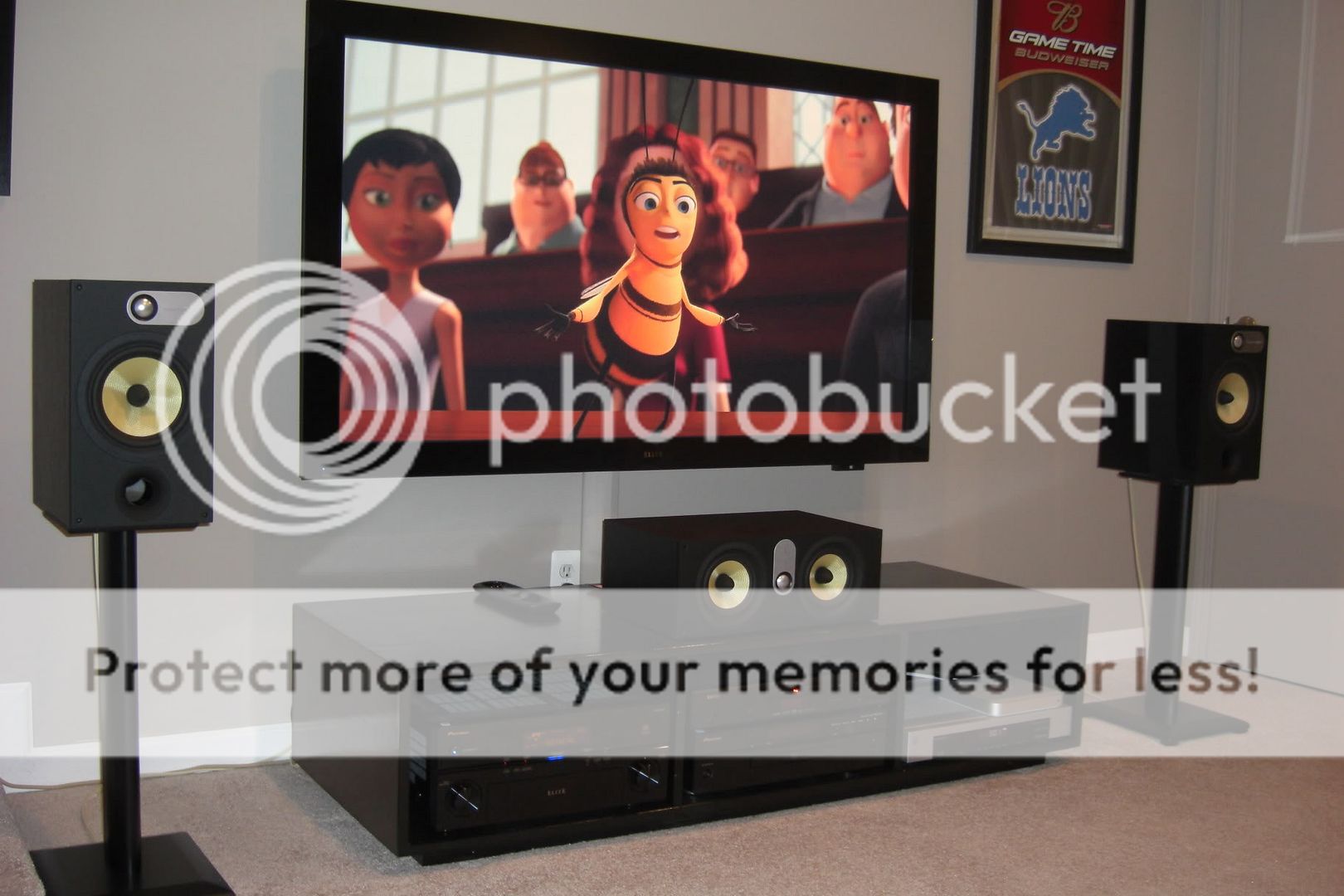

OP's setup:
Your setup is not well aliened. Put the receiver under on the 2nd or third shelf. You should never ever put anything on top of it. Leave the center speaker on top. I would keep the receiver and get new speakers and a 2 Dayton 1200 subs.
Plus you need stands: https://www.amazon.com/VideoSecu-Adjustable-Satellite-Speaker-MS07B/dp/B000VRREPG/ref=sr_1_5?ie=UTF8&qid=1467941308&sr=8-5&keywords=Speaker+stands
Examples how it should be setup:
or
You can look at more setup's here: http://forums.audioholics.com/forums/audio/pros-and-joes-systems-gallery.13/
Your htib has a relatively decent receiver. First thing I'd upgrade is a much more capable sub, can go a long ways for improving modest speakers. You probably just need to setup what you have better and have some furnishings to have your room help out to start before making decisions on gear.
Your particular room is a big part of what you hear, as well as speaker placement for your listening position(s). Your speakers are poorly placed as you have them now on that bare floor; suggestions for stands are probably good, depending if they are actually suitable for wall mounting (didn't look them up) and are not rear-ported or anything? Sitting on the floor like that with your center on the avr, not so much.
Don't block airflow to your avr as was noted, that can kill it good, agree with the move it down one shelf suggestion. The center should be placed so it does not reflect off the shelf, so place it at the edge and angle it up at your listening position, a number of household objects can do quite well helping with the angling thing.
Try some changes and rerun the auto setup routine then start to make some judgments for gear....

Afterlife is correct. You will want the speakers at a height such that the tweeters are level with your ears where you are normally seated. You will want to aim the speakers to be facing the listener rather than facing straight ahead. You will want to give the speakers a stand-off distance from the walls- I would give them a couple feet from both the side-walls and back wall. You will want the speakers to form an equilateral triangle with you as the listener, where there is as much distance between the speakers as there is from the listening position (this is only for the front left and right speaker, not surround speakers or center speaker) thereby forming a triangle with all sides the same length. While you can still achieve a nice sound without following all these placement principles, these are typical for optimizing speaker performance in normal rooms.

You should be ok with the Polk speakers for now. I still recommend getting The Dayton 1200 subwoofers to even out the room. Please post pics when you get setup everything. We are here to help! Also make sure the center speaker tweeter is dead center with your TV logo.
afterlife2
afterlife2
Also try to put a couple of lifts underneath the center like this:
