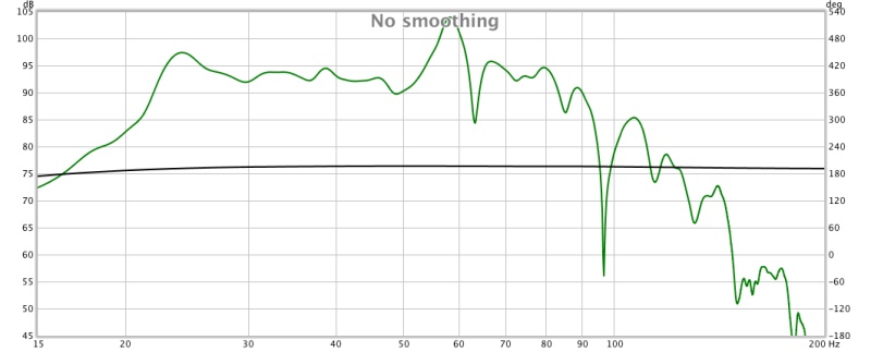

Having the worst time getting REW to work this morning... between it, pre-pro, TV, and my Mac bickering about HDMI output, not liking the port noise these things are making, and image export acting goofy... I'll give it a shot anyway:
This is the "left" sub, placed approximately mid wall opposite the other one. I started at corners, and moved further along the wall until it wasn't so darn boomy at the listening position.
Audyssey is off/but I believe crossover is still engaged at 80hz.

Is this the left sub only? The roll off matches the FR spec at 24hz. Your definitely missing out on some low end punctuation. I'm gonna guess that 58hz peak is from the 10' room height mode. Only way to help that is EQ I think. As far as the sloppiness, I would say that's due the quality of the klipsch subs in general. They're not known for making great subs and that's in part due to lack of driver control and a higher Q design. They're just not very linear, and controlled.

Thanks for taking that measurement for us. That response isn't all that bad, except for that bump just under 60 Hz, that would add some boom to your bass since it occurs at such a critical frequency. EQing down that peak might make a big difference. Could you post a waterfall graph of that measurement for us? I would be interested to see what else is happening.

While Audyssey does do a lot to improve the response, there is still room for improvement via equalization, specifically the hump between 50 and 60 Hz. It is not much of a bump though, only about 5 dB. I think at this point it worth it to step up to better subs, but further equalization wouldn't be a bad idea either, depending on how fussy you are about the quality of bass. If it were me, I would be looking at a couple Hsu VTF-3 mk5s and a miniDSP. The VTF-3s can run in sealed or ported operation so they should able to play well with your room no matter what. The miniDSP will have more EQ power than even Audyssey XT32, so you can get an even better response. All that would come in at a tad less than $2k. It will play a lot deeper, much more powerfully, and more accurately.
