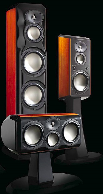

For speakers, I would get either the Revel or KEF systems.
The Revel Ultima 2 sytem: Salon2 Front L/R, Voice2 Center, Gem2 Surrounds, Rhythm2 Subwoofer.
The KEF Reference system: 207/2 Front L/R, 204/2 Center, 201/2 Surrounds, 209 Subwoofer.
http://www.revelspeakers.com/ProductDetails.aspx?prdid=2
http://www.stereophile.com/floorloudspeakers/608revel
http://www.kef.com/us/loudspeakers/reference
http://www.stereophile.com/floorloudspeakers/208kef
