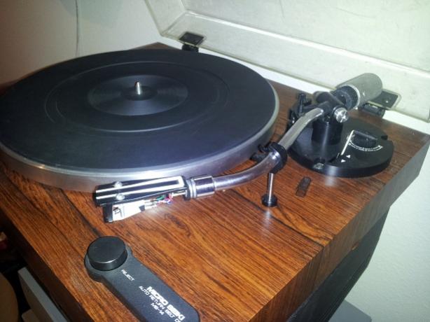

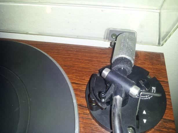

Actually not all arms need a decoupled counter weight. However most pickup arms are highly problematic.
The type of tube arm in the turntable in question with detachable arm really sing in the 200 to 300 Hz range. Decoupling the counter weight helps lower the Q of this resonance.
