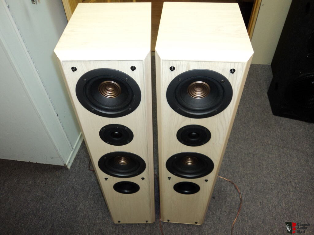

My first foray into Home Theater was a Technics system including the Technic speakers below.
The strange thing about these as they had on eport in the back as well as the front.
Here's another pic with back port..
So do you know what advantage the dual porting was purported to provide for the speakers?
