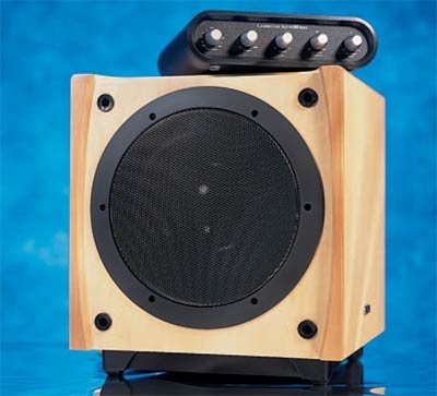

Is that the ensemble set with the "subs" like these?
I had a set of these, they're nothing like an actual subwoofer :) You can do quite well going DIY with that budget...
PS Just noticed you mentioned a psw model, these were passive. Still, the Cambridge SW subs can easily be bettered these days....

No those are actually part of the front mains, they were like a 2 piece speaker a small bookshelf and those were paired together. I also have a separate powered sub model PSW

:eek: I remember those. Yeah, not exactly a sub, they were basically the bass module for the sats.
The last subs they made, the P200 and P500 were dual opposed driver setups with a BASH amp and controls that were remoted to save space and were not bad. Still not competing with SVS, HSU, Rythmik, etc...
