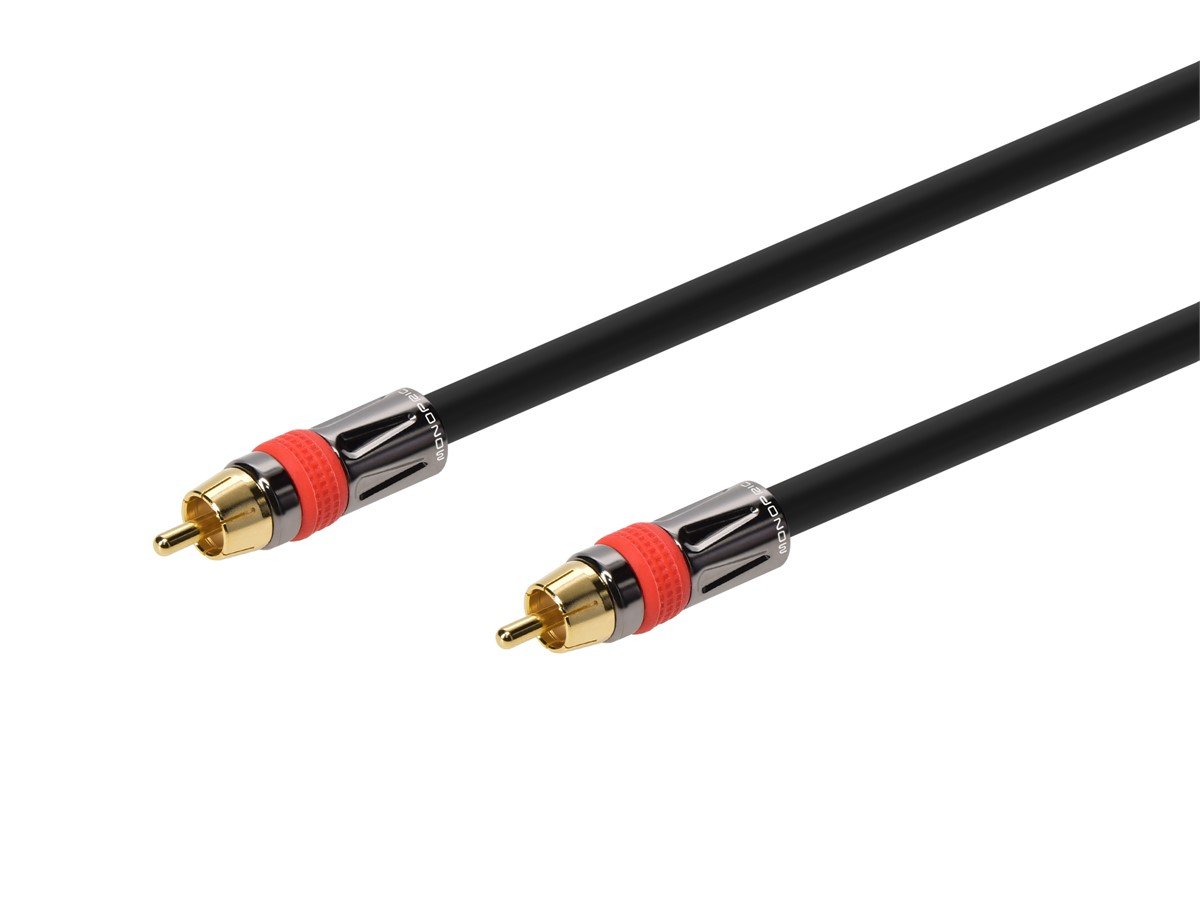

Yeah, you need to run subwoofer cables to at least the front two corners. And while you're at it, might wanna run cables to the back two corners as well.

I grouped my sub cable connections with my front speakers for a clean look:

i can't put a sub in the front one side...are you talking about sub cables to the back corners? or speaker cable to the back corners?

Also, if i need 40 feet for one back room and 55 feet for the other corner...do it with sub cable? or do i need to use other cable to transfer so i don't lose quality?
