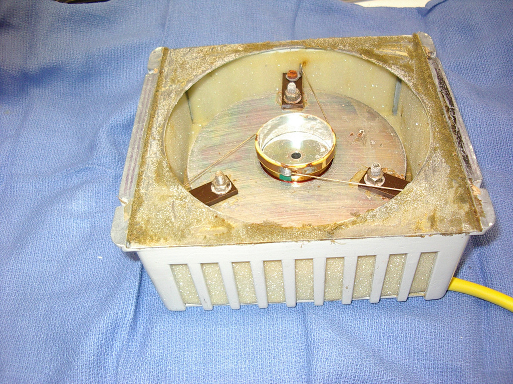

In my view this driver is easily the best wide band driver that has so far appeared, and we are going back to 1961 with this one.
I have started to slowly go back to my work on the development of the Mk III, back forty years ago. I think with modern manufacturing techniques, this driver can be developed into the finest high powered mid range available. I think it is capable of a bandwidth of 200 Hz to 6 kHz, may be 80 Hz to 6 kHz. Even with that bandwidth, I think first order crossover would still be possible.
The module in its current form when uses as a mid range driver, does not need to be crossed over on the top end. All that is required is one cap to the tweeter and an L-pad. This gives only 45 degrees of phase shift.
So I am looking for a way to accomplish that.

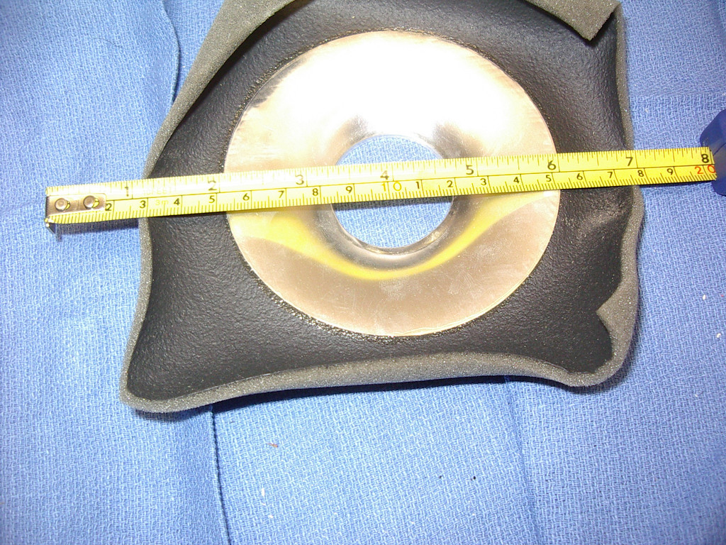

Hi Mark,
What material is the cone made from? The brochure just says "metal alloy" although I'll admit to not reading the whole thing. I'm on a HP Mini and the screen isn't very large...
Hi Mark,
The cone is made of spun aluminum, which in the early years was anodized, which caused many people to think the cones were brass which they were not.

They look like the hub caps from an old Ford Econo-line van I owned briefly. Fascinating.
DJ
DJ
Not really. The cone is 4" in diameter. The total moving mass is only 6.4 GM, which is less then a quarter ounce. So the cone is basically foil.
Despite the light cone, the Fs is in the neighborhood of 40 Hz. In a TL very useful output is possible with these speakers down to around 40 Hz.
Most of the production of these speakers went to the Far East. They have maintained cult status in the Far East for half a century now.

Oh, OK. Perspective goes a long way. They looked bigger in the pic than they actually are.
