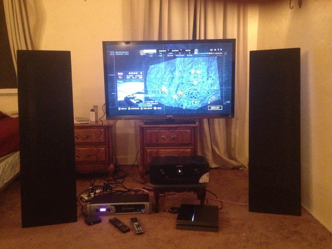

Ordered: SR 5008, XLS 1000. Thanks so much for your help everyone, especially TLS guy and Adam. I will let you know how it goes on this thread!
C
c21manuel
I'd like to thank everyone who took the time to answer my questions, pick stuff out, and even showed me how to plug some stuff in. This sounds great with both my music and my ps4. I have the airplay running pretty well to as I also got an apple TV, but it has it's moments where it's really choppy. I think that has to do with the wireless network.
