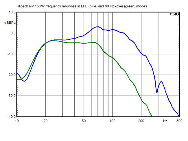

    It depends - it's performance is not bad and can be a good value if you can get it for $500, BUT at it's MAP of $899 there are better options for sure. HSU VTF-3mk5, Reaction Audio, PSA and new Rythmic FVX15 sub.
    You got to understand something here: The DIY Kit I linked above and you could build it around $500 will closely compete with these 900-1000 commercial offerings.
    Review:
    http://hometheaterreview.com/klipsch-r-115sw-subwoofer-reviewed/?page=2
    [​IMG]
    Maximum output
    CEA-2010
    (2M RMS)
    63 Hz 114.3 dB L
    50 Hz 115.7 dB L
    40 Hz 112.4 dB L
    31.5 Hz 109.6 dB L
    25 Hz 104.8 dB
    20 Hz 99.7 dB
    To rephrase a words from BOC song don't fear the BASH. This specific amp design doesn't necessarily makes HSU amps less reliable. HSU sells thousands of subs, and I yet to hear any noticeable mentions with their amps.
