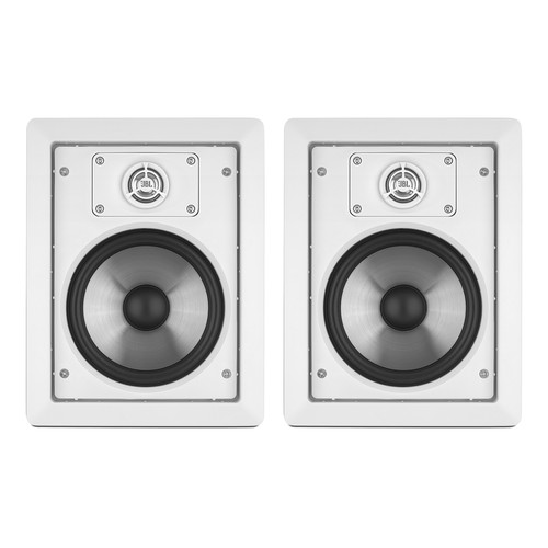

Thank you. What is everyone's thought on the following setup:
JBL ES25C - center
JBL SP8II - L/R
JBL SP8CII - rears
I can get this for $900-$1,000. I am new to all of this so if you have a better reccomendation in the same price range, please share. Needs to be in-wall L/R and in-ceiling rears.

The ones I linked you above are of better quality for less money and have more thought put into their designs as their entire business is custom installation. Their now parent Holding Co. also owns Elan, Speakercraft, and Russound; all of which are CI based. The JBLs are Audioaccess' speakers rebranded. The originals can be found here at a much lower price. They use a different woofer on the sp8, but the tweeter is the same. Whole setup $425.
