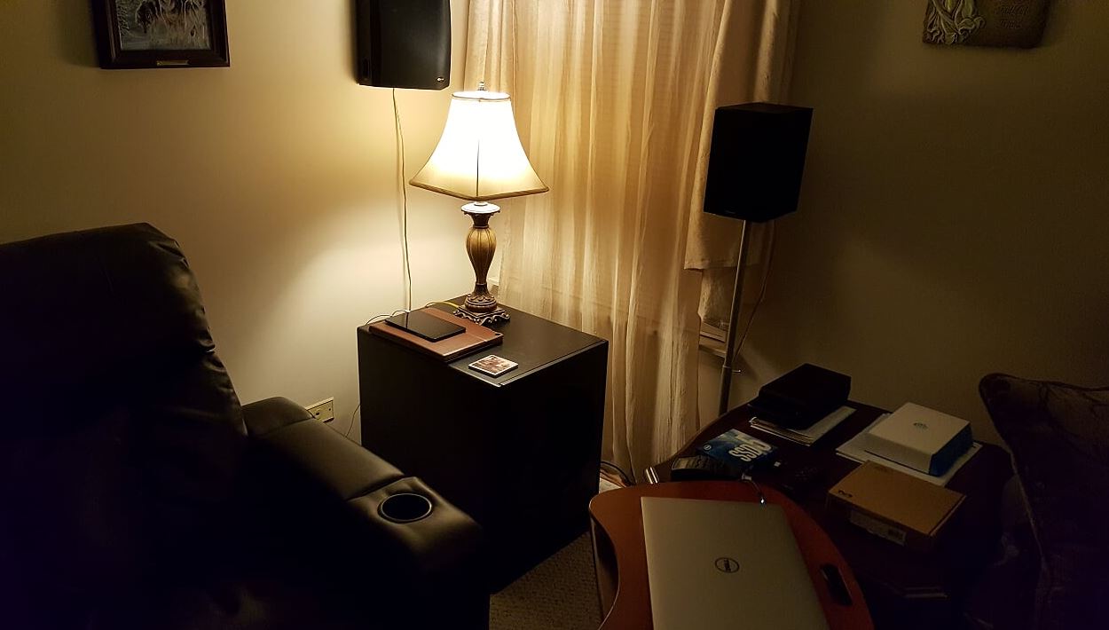

The wife has been kind enough to allow the insane amount of speakers I have placed into the room, now to include a 3rd MFW15. She flat out refuses moving the recliners away from the wall because the only entrance into the room is next to her recliner which if moved forward will block the entrance.
Adding this third subwoofer as is of course sounds horrible because I couldn't run REW or Audyssey so while she was in the bathroom I did a quick level adjustment and tried to get it sounding good before she came out. The sub was very easy to locate no matter what I did so she has a hair appointment tonight which means I have about 2 hours to try and dial it in. OR, wait until the next time she is at her parents house, or I get her drunk and she goes to bed early....

The listening positions are against the back wall, I sit in the chair on the right, about 2ft away from the back wall. It could be worse, we could have had a vaulted ceiling in this box of a room. o_O
What I would do is level match each sub using the gain knob to 75dB, then adjust them all together via the gain control in the receiver to 75dB. If the sub is directly across from the front subs, flip the phase switch to 180 degrees and see how it sounds. What crossover point are you using? Maybe try going below 80hz. I know in my square room I had better results crossing over at about 50-60hz. What speakers are you using for all channels?
