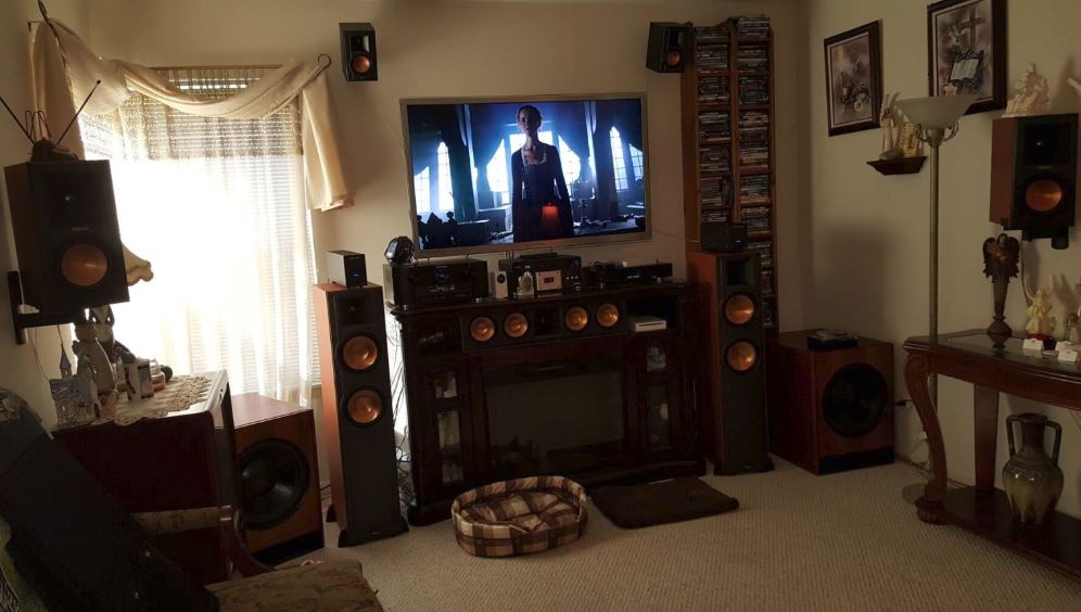

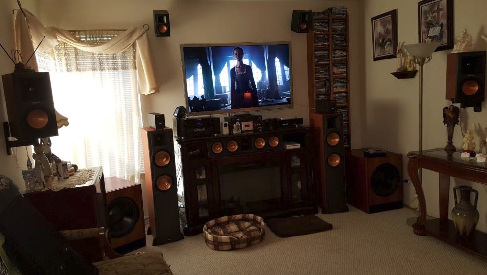

I have two Seaton powered MFW15's in the HT right now. I'll be adding a third MFW tonight or tomorrow night depending on how my back is feeling.
I am going to try running Audyssey with the 3 subs hooked up, 2 fronts on one output (as people have recommended) and the rear one on the second output and I will calibrate them all together as Anthem prescribes instead of how Audyssey does via matching which has not had the desired result.
If it still doesn't sound the way I like then I'm looking to purchase the MiniDSP for the 3 subwoofers and have the subs obviously connect via that.
I figure I'll let Audyssey calibrate the rest of the speakers and Dirac can handle the subwoofers. At this point as some people in this forum know I have MultiEQ32 turned off and bass response is hugely improved. MiniDSP is a decent amount of money but honestly I want the system to sound its best and I'm sure with MultiEQ off as good as the system sounds it can sound much better.

You have a tolerant wife. What are your questions?

It's much cleaner with the grills on. I'm wondering if using the MiniDSP just for the subs would yield a better bass response considering Audyssey calibration the entire room sounds like a big null except for at the MLP which even though has more bass still sounds negative until MultiEQ is turned off.

I guess I like my stuff eq'd. I'm pretty happy with Audyssey right now, and I even like the Dynamic eq on as well. To me, it just sounds fatter and brighter. A little bright doesn't bother me as I have significant hearing loss, so I think I perceive it as more detailed.
In fact, Klipsch might not be a bad choice for me in the future... :eek: I have to get out and demo some more of their stuff. The only thing I've heard are the basic Best Buy floor models. They're okay, but I know Klipsch has better to offer.
While I'm happy with Audyssey, I'm planning to get a MiniDSP and a mic to really dig in and get my system dialed in.
Which minidsp product are you thinking of? Using their 2x4 units for subs doesn't utilize Dirac.
Audyssey essentially uses level matching, you're thinking of gain matching instead? I'd still try letting SubEQ/XT32 work with the three subs (2 equidistant on one output, the other for the different distance) before your next step, it may resolve your issues.

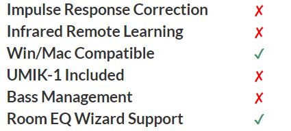

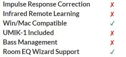

None of the MiniDSP models have bass management except the DDRC-24 which costs $450.00, the 2x4 balanced version Gene used for his system has no bass management either. Isn't the idea of using this putting it between the AVR and the subwoofer(s) to manage them?
I'm feeling pretty stupid asking and I'm hoping there is a simple answer aside from using REW which will only help me adjust the subwoofers themselves (placement etc) and the AVR settings. Is it he just used it to EQ the subs, I do see he has it installed in his system sooooo.
For $450 wouldn't I want to use DIRAC Live and leave the DDRC-24 between the AVR and subs as he did only using DIRAC to modify their output?

You're mixing up concepts/gear a bit. What are you defining as bass management?
REW can analyze your room and suggest an eq which you can implement thru a minidsp unit (2x4 or others) or even a Behringer iNuke dsp amp or other units.

I guess what I was hoping for was bass management that could be done outside the AVR, since the DDRC-24 does have it I assumed that I could use DIRAC to manage the subs?
