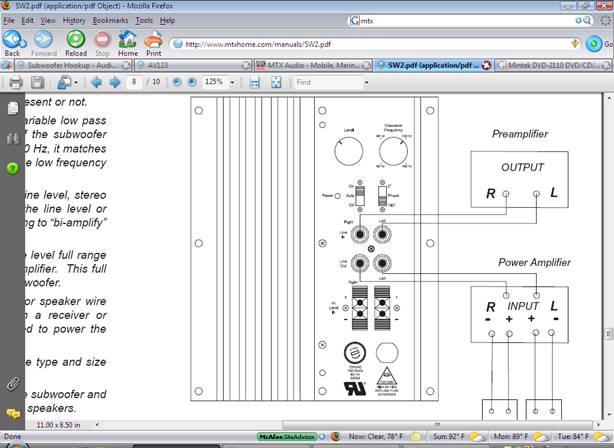

I really appreciate your help but being new to this, I'm not sure if I understand. The receiver is indeed a clone of the Onkyo 590 receiver and it has a purple input labeled subwoofer in the DVD mix of inputs. Not sure if it would be considered seperate. Here is a picture of both the receiver and sub. Let me know if the y adapter will work..thanks!

Well I had to go get the manual for the Onkyo because it was hard to see what's what but I'm sorry to say that it does not have a subwoofer pre-out. It has speaker level outputs marked subwoofer so it expects a non-powered subwoofer.
The hookup diagram for the sub shows Line-in from the pre-amp and Line-out to an amplifier so it is a passive sub (no internal amp).
The best you can do is connect speaker wire from the receiver to the speaker level inputs on the sub which I gather is what you have already done.

Your receiver has a high level subwoofer output, it uses speaker clip terminals to connect a to a passive subwoofer that was supplied with the Home theater in a Box. Not to worry though. all you need is one speaker wire of at a minimum of 16 gauge to connect the MTX sub to the receiver. The MTX has High level inputs signified by the speaker clip terminals. Connect on end of the speaker wire to the receiver's subwoofer speaker clip terminal output and connect the other to either the left or right speaker clip terminal on the MTX, connecting to both speaker clip terminals at the subwoofer is not necessary, one will be fine.:)

The connection you have made is the best it can be with that receiver, but it should work fine.:)
