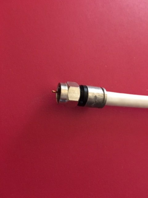

Several years ago my apartment had cable TV / internet installed and the cable company (now out of business) used this kind of cable:
It is about 35 feet long with same connector both ends. I am thinking it could be used now, with RCA adapters on both ends, as an LFE cable to connect a second subwoofer near the opposite wall of my apartment. Any thoughts? Or should I forget this idea and just buy a super long RCA cable?

That cable is terminated with f-Type connections and is designed to give very low loss and high shielding to an satellite/aerial signal. But it will technically work fine as an audio cable but it is WAY over spec for this and very stiff. You will find it very hard to bend this in behind a subwoofer because of this. If you bend it to tight it might break the internal connector. You also can't get RCA plugs that will attach to that cable thickness. You can get little F-Type to RCA adapters which would screw onto the ends and allow you to use the cable though. Just search for "F-Type to RCA adapter". I think you need a male RCA to female F-Type one.

By the time you figure the cost of getting the two adaptors you need. you might just as well go for this.
http://www.amazon.com/Mediabridge-ULTRA-Subwoofer-Cable-Feet/dp/B0041OOFE8/ref=sr_1_1?s=electronics&ie=UTF8&qid=1464557576&sr=1-1&keywords=35+foot+subwoofer+cable
