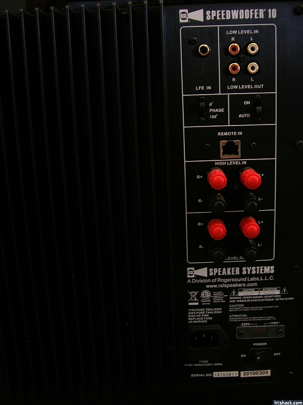

Went with RSL Speedwoofer 10s.
There are too many connections in the back of the subwoofer. Where does the subwoofer cable go?
Good choice.
Right where you see "LFE IN".
