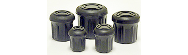

I aim to try and turn this pile of aluminum into stands. Picture a simple, four poster design, with the rounds at the 45 degree position off of the corners of the speakers with the part that cradles the speaker an inch below the tops. The plasti-caps are for the tops of the rounds, and I will add black rubber chair/crutch tips on the bottoms. They will be black to match the speaker grilles and faces.

Chair tips something like this.
