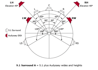

I would actually consider a 9.1 audyssey dsx or even a 7.1 DSX system. Most 7.1 systems have S.back speakers wich are basiically useless because you never hear them. Audyssey DSX lets you wither pick either height speakers or wide speakers (wides give you a bit more impact) or both if your reciever supports it. Keep in mind to use A-DSX your reciever must support it. what this does (short version) is ables all 5.1 content to be heard in 7.1, 9.1 or 11.1 (via pre-amp for 11.1...agin useleess because S.back is used).I have 9.1 (soon to be 9.2) and I use only klipsch reference. For your surrounds go with the RB-61II....you could go with RB-81II but the RB-61II are better because they are easier to hang and sound exactly the same...I had both. RB-51II would not mach up at all with that center and mains. Your surrounds should be 110 degrees about 4-6 feet behind you, and 2-3 feet above the listeners head, I also suggest you use Auralex mo-pads under them. I would noot suggest bipoles, direct firing is much better IMHO.

The RS should be used as your surrounds. They have the Wide Dispersion Technology. This is what they are made for. The RBs are a direct radiating speaker, you could use these in the rear.

Agreed, but in alarge room I found I really disliked them....but in my Dads smaller room they sounded good. Could just be my ears to.
