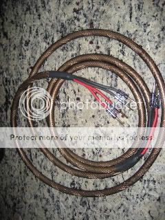

    This is still my favorite, it is very nice and not too expensive.
    I also like what Haoleb made.
    [​IMG]
