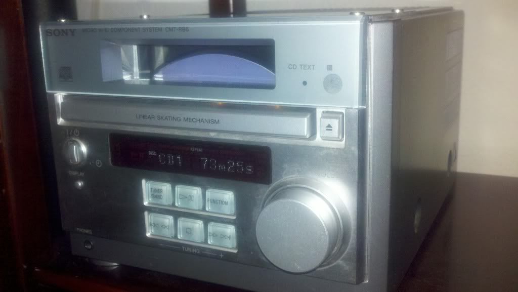

The head unit is the most crucial part here. It's graceful design lends the eye a treat. The face is very thick glass and aluminum. The mechanism for the CD loading is among the niftiest I've seen. Upon touching the conductive eject button a small flap moves aside and a carriage moves upward. You place the disc on the carriage and touch the eject button again, or press play, and the carriage lowers the disc into the transport, the dust flap closes and the transport locks the disc in place. Sony put a lot of thought and engineering into this design of this player. The mechanics are excellent, the transport noise is low even on stand alone CD player standards, and the glass has a frosted line at the 9 o'clock position to shield the laser light from ignorant eyes. The quality of playback is also excellent as well as the amplifier noise performance with speakers and headphones (note: the headphone jack is placed on the rear so as to keep the front panel looking uncluttered). The CMT-EX1 could also be used as a transport by using the optical output.*

Here's mine:
Both the kids had it as their system for a few years each and now it is back with me since they are both out of the house. It is older than my son and he can legally drink this year :/
