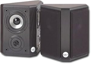

Dave If you can get Wharfedale WH-2(discontinued) on Ebay I think you will like them. I have 2 pairs as front highs/surround back:
