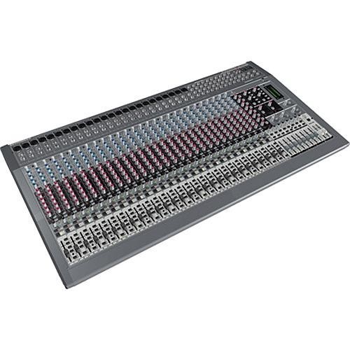

If you have four stereo devices to connect in a mixer, you are going to need an eight channel mixer. Something like this would work well. You might look on ebay for used mixers as well, there are a lot of good deals on decent analogue mixers when a lot of guys dumped their mixers for digital and USB mixers.
Here, get this one so you'll have room for expansion:
