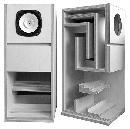

Is this the enclosure op is talking about? Is this what could be considered a TL speaker? Or just a horn loaded speaker?
That's the enclosure, as far as I understand, it's a horn. I remember back when my friend built it I did some reading, and for the full range drivers you really needed a horn to fill out the bottom end.
Back then, say 10 years ago, you could buy the setup built for 1200 or so. NO idea how it compares to 1200 setups right now.

That is a horn loaded enclosure and not a TL. Drivers like we are talking about are very low Q and very sensitive. So innately they have virtually no bass response. So they need a highly efficient horn to pull up the bass to match the mid and high end. This approach can sound very good indeed, especially the Lowthers. These have undergone continuous development since the 1930s when the concept was developed by Paul Voight who founded the company. His design is widely recognized as the world's first truly high fidelity speaker.
