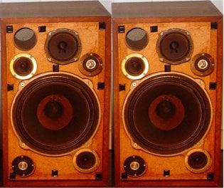

IMO, first order corssovers should be left in the 70s along with these, these, and these

Nice explanation, by the way I liked those crappy 70's 1st order xover speakers:D;)
