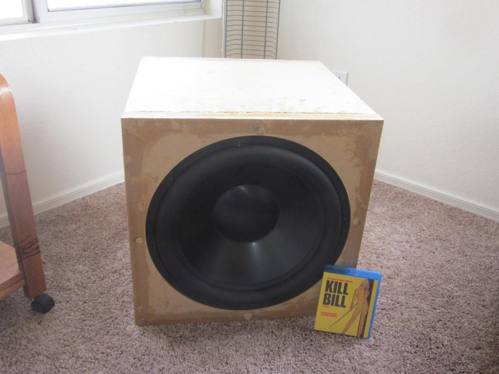

    This guy fade to black did a great job:
    [​IMG]
    This guy Shackster A little too big, but nice:
    [​IMG]
    Wish I had all those tools...BSA are you gonna buy the box and install it???
