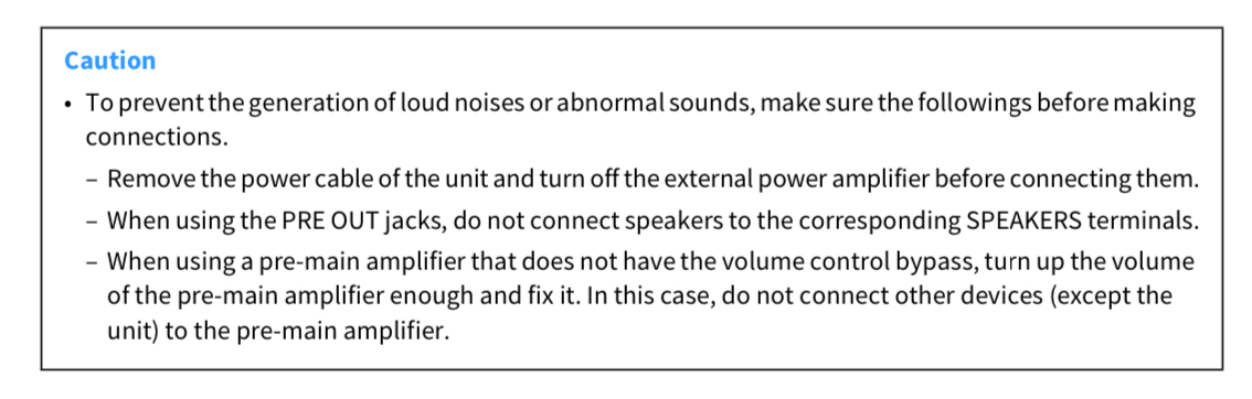

Yes, the speaker level outputs and preouts will work at the same time, whoever said they won't isn't helpful. ALont with what TLS said, not only will the volume control only work for both at the same time, Room A and B will always be playing the same thing if you connect it this way.

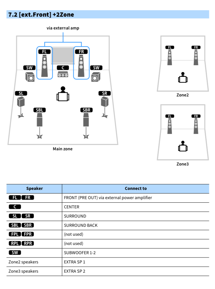

With the RX-A2080, you can have a Main Zone, Zone 2 and Zone 3 with the following amp assign using an external amp for the front speakers.

You have the amps. What you do not have is the ability to configure them as needed here. The amp assign I posted was about the best you can do with what you have here. The Basx A5 is meant to power the main five channels of a pre pro or receiver. You need a multi room amplifier connected to your Zone 2 pre out to send the same Zone 2 signal to several rooms at once or separately. Hopefully, @BMXTRIX will step in with some suggestions.

I don't really have a lot of input here. The main L/R amp channels in the receiver are locked to those channels, so if you don't use them, then they can't be repurposed for other rooms. So, you can certainly run the zone 2 speakers off the amplifier, connected to the zone 2 preouts, or you can run zone 2 as the 'extra speakers 1' output off the AVR if you would like. Either one is fine and should work. I would lean towards trying it out this way first. The run the outdoor speakers as zone 3 and take the preouts to your external amplifier and run the outdoor speakers off outputs 3&4 of the external amp. Run the main speakers off outputs 1&2 of the external amp.
You can always adjust things as you need to, and you can add a extra amp in the future if you want to. I wouldn't blast music in the indoor zone, but you will have plenty of volume for general music background listening at reasonable levels. Outdoor can likely get solidly loud.
In the AVR you can setup zone 2 for fixed audio level output. So, that way the ONLY way you adjust volume is at the volume controls. At least, that's been my experience with zone 2 or zone 3 setups. The volume can be fixed or variable. If you have volume controls, set it to fixed, if you don't have volume controls, set it to variable.
Don't try to get to fancy with the AVR. You only have 9 total channels of amplification in it, despite the 11 connection points, so you will need to use at least a couple of external channels to get things working right.
