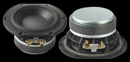

  • Woofers: (2) 4″ with Ferrite Magnet, Polypropylene Cone, Cast aluminum frame.

  • Woofer: 4″ with Ferrite Magnet, Polypropylene Cone, and Cast aluminum frame.

Click on the attached pictures to zoom in!
