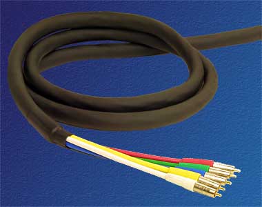

RGB/HV cable consists of 5 coax cables. Most often the cables are terminated with BNC plugs, but sometimes RCA plugs. RGB is basically another way to terminate a VGA cable. A picture is below:
Now, if you only need a three-coax cable, that is a "component video" cable, which again can be run as three separate coaxes or as a single bundle. Since you're making a pretty long run, I would recommend that you get a cable from Blue Jeans using broacast-quality Belden coax. Since 20m is about 65 feet, a run of Belden 7710A Cable terminated with RCA-jacks (basically three 1694A Coax cables in a rubber jacket) is $190.25 + S&H and a run of three independent 1694A Coaxes terminated with RCA-jacks is $123.00 + S&H.
