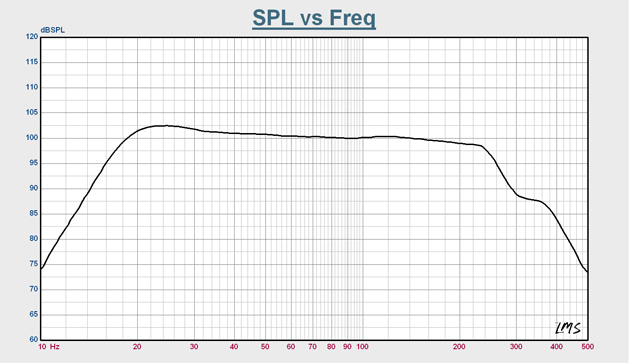

* svs sb2000 (these graphs seem to show they do relatively well at 180-200hz -or do i misread them?- : http://www.audioholics.com/subwoofer-reviews/sv-sound-svs-sb-pb-2000/FRPB2000.jpg/image_view_fullscreen)

* bk monolith df (not sure if too big / too powerful for my room, http://www.hometheatershack.com/forums/subwoofer-tests- archived/974-bk-monolith-df.html)

I would narrow down the choices between the BK Monolith or PC2000. I would probably lean to the PC2000 if raw performance is your goal. However the cylinder look isn't for everyone.

I personally run 2x BK XXLS400-DF and they are great for music and movies. Out of your options I would get XXLS400-DF if you dont want so much output, if you do, Monolith+ would be great choice. Arendal is pretty new thing and there is not so much info about their products yet, like measures and such.
