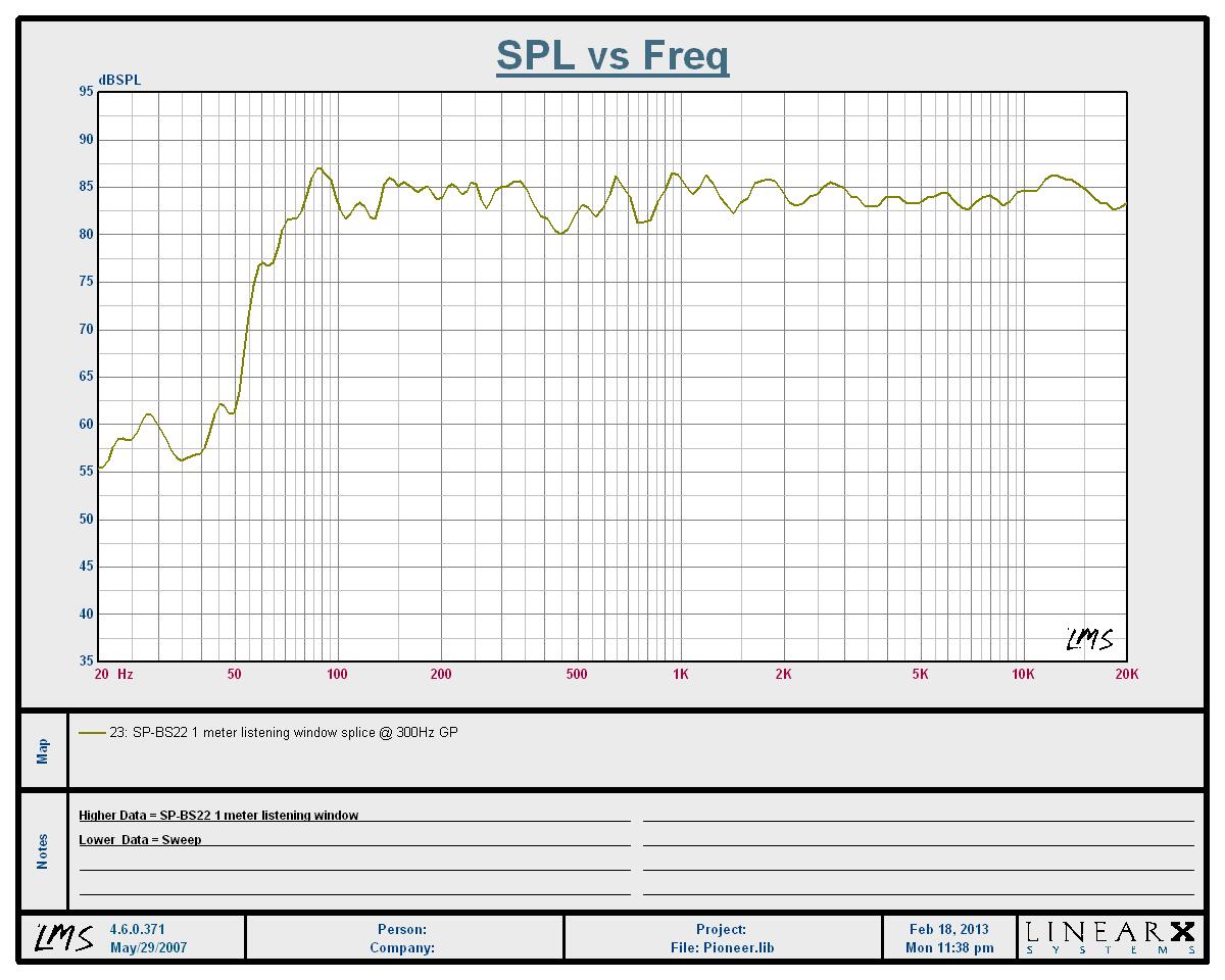

Not sure what people mean by these don't have bass? For a 4" driver, they have surprisingly good bass and can handle a medium sized room with adequate power. Since it is just for music, I'll agree with ImcLoud on the X A-100 or TP60, I also own both and either will be plenty to drive the BS22s. I'd probably opt for the A-100 simply because it has an output which means you would be able to feed a sub line level signal from it. You'd have to figure out another way to use the AirPort though.

It could more than OK for 4" woofer - SP-BS22 listening window.JPG Full Screen Image | Audioholics , but it would benefit very much so from pairing with good musical sub even for music ... (depends on type of music of course)
