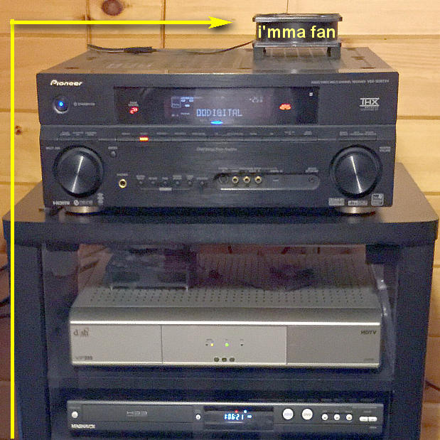

I don't know guys...
I have a Pioneer VSX-1016TXV (owned 9 years) and a very similar setup to the OP (see sig), and I've never had a problem with running it hard in 8 OHM mode with a full Primus setup...
The VSX-1016TXV is on top of my rack with a silent fan on top to draw hot air out though...
The fan is plugged into the VSX-1016TXV (turns on with it) and does help keep it cooooool...
I think an AVR with a robust amp section should be able to handle the Primus setup just fine...

Yeah, I'll go for that, esp if you have some extra cooling going on. The main item to point out is the discrepancy between the manufacturers ohm rating and the actual measurments.
I doubt that my Pio Elite VSX-82TXS is truly rated at 4 ohms, but I wouldn't be too worried about driving the Primus line off of it. I would just hook it up and drive it hard for a while and get temp readings every few minutes with my IR thermometer. I never tried it, that's not the area that I bought the 363s to play in.
