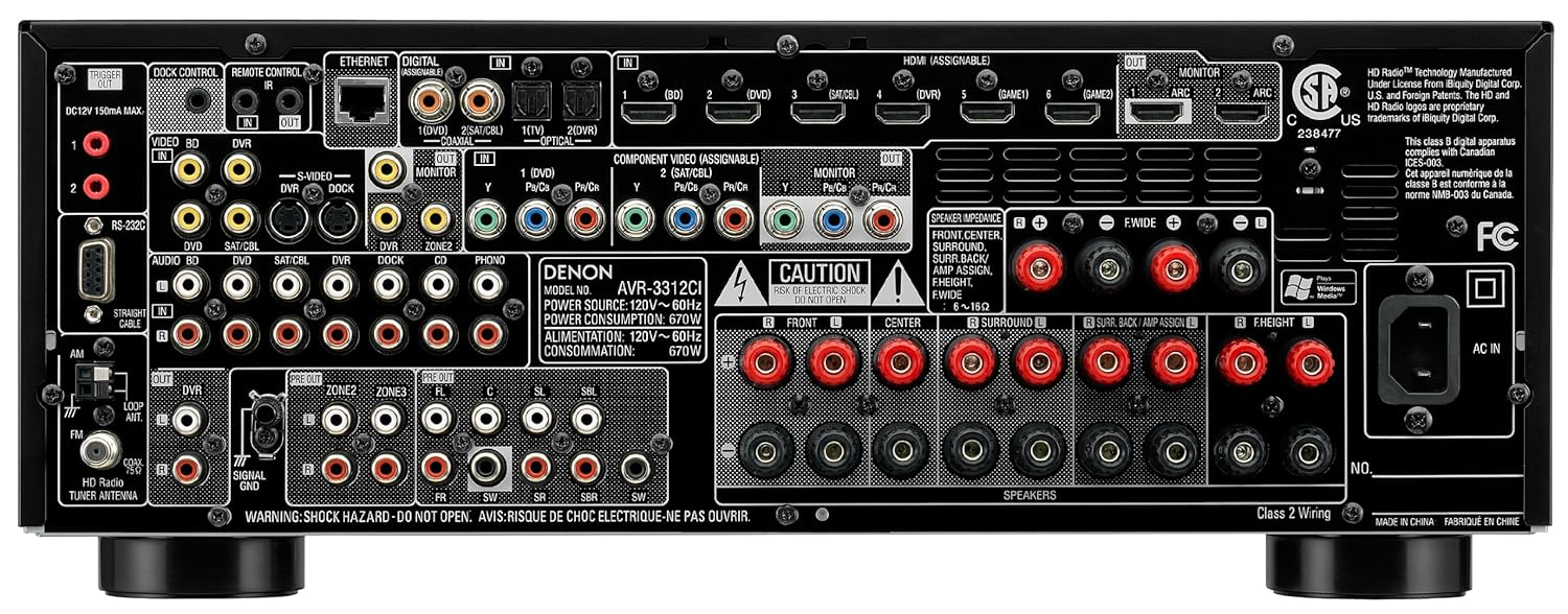

I think that won't work like you think. The NR-1506 is an AVR, not a preamp.
Here is the back panel of the NR-1506 (click on image to enlarge). It only has pre-outs for the front L & R (and subs). You will not be able to use the 5 chanels of the amp you have ordered.
You can instead, buy a two channel amp and use the NR-1506 to drive the center and surrounds, or get an AVR with 5 channel pre-outs. There are probably less expensive models, but here is the Denon AVR-3312CI as an example of what you are looking for (it has 7 channel pre-outs just to left of speaker terminals):
Good point. That first receiver did have front R/L (only) preamp outs and that was stuck in my mind. I didn't catch that the external amp went from two channels to five.
KEW, you're exactly right.
My suggestion is for the OP to start w/ a good and strong AVR, like the Denon 3312CI, X4000, or Marantz 7008. (I should have taken the time to investigate his choices and check for compatibility. Didn't think it was necessary.)
Odessa_Man, the answer to your question, "should I save up and get the marantz SR7008", is Yes... or some other comparable AVR w/ preouts and power. Enjoy the heck out of it, and add any amps at your leisure and convenience.
