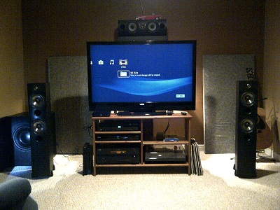

I have the little brothers, the T45s. These speakers need to be pulled from the wall or else the bass will sound boomy and bloated. Here's a pic of my setup.. 18" from the side walls and 26" from the back wall.

Thanks for the replies! Yeah my main concern is massive depth of these speakers at a full 20" deep. Add that to your 26" off the back wall and you won't be able to stop tripping over them!

I really like them. They are very neutral sounding and throw a nice deep soundstage. They go deep enough in bass for most music. They're revealing to a fault where a bad recording will sound bad. They hide nothing. On the flip side, good recordings sound fantastic.
