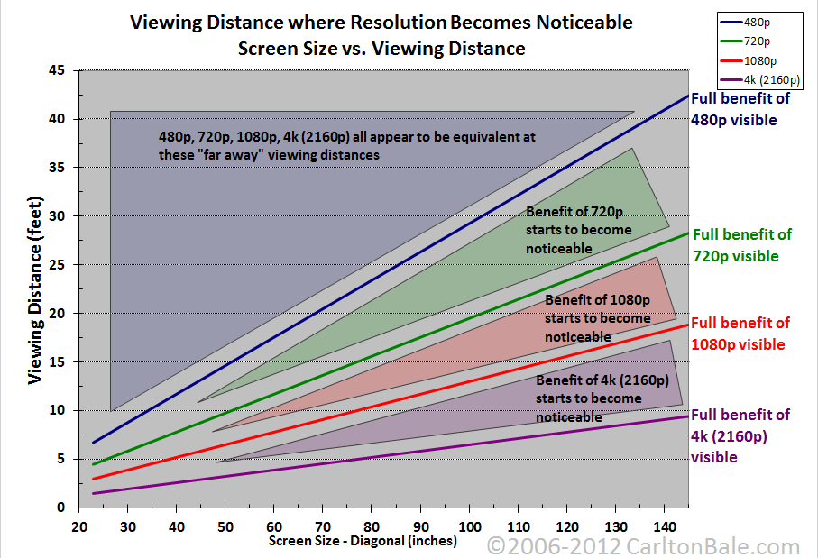

You want to size the screen for the 16ft distance. If you go too big, in the interest of accommodating the 28ft distance, the folks sitting close will get screen door effect.
At 16ft a 143.5" diagonal screen will give the 36 degree viewing angle recommended by THX. SMPTE is less at 30 degrees, so smaller 120" will do. In fact, even 125" will suffice for fully resolving 1080p from 16ft.
From here, http://carltonbale.com/1080p-does-matter/
