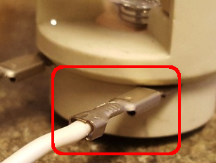

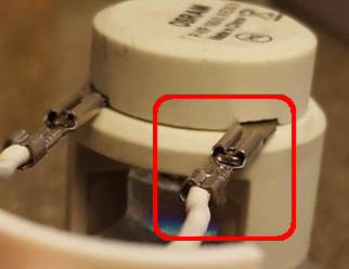

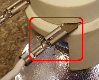

I am replacing the bulb (MC.JH111.001) on my Acer Projector H5380BD. While removing the connections on the old bulb I came across the following clamps. I cannot figure out how to remove them. Any suggestions would be appreciated. Thanks.

Those should pretty much just pull right off. There may be a hole or dimple on 1 piece and a nub on the corresponding other piece that slips into the hole or dimple. If it has that, then you may need to use a small flat blade screwdriver to help disconnect the nub while you pull the connector off

Thanks so much for the quick reply. The clamps were extremely tight and required a screwdriver and a lot of carefully applied force, but they did come off. I appreciate the help!
