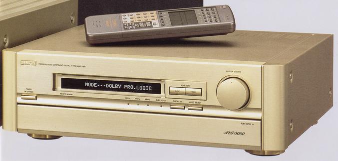

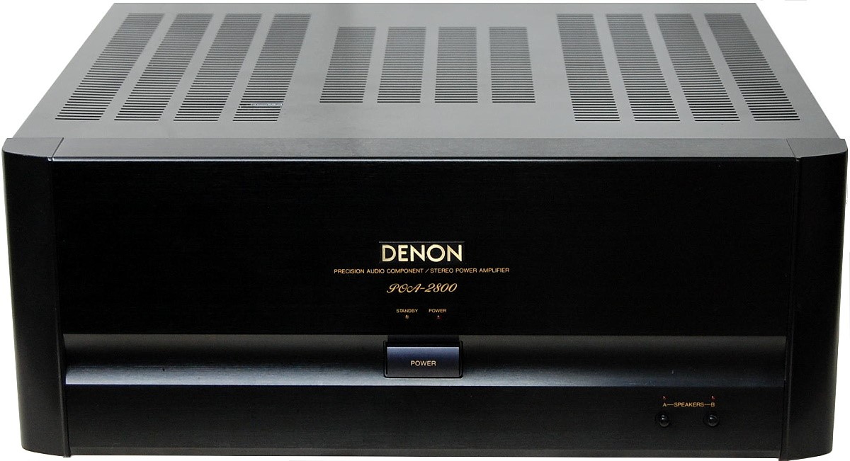

I want to set up a movie theatre using my really old Denon amplifiers. It was Denon AVP-5000 preamp with 2 POA-2800 amps. I hate to throw away those monster pieces. So I connect Sony blueray to TV by HDMI cable and use optical cable to receiver. However, when I played movie in 5.1 DTS, it will only produce loud static white noise. It would play 2.1 movie trailer with no problem though. I changed the source to regular DVD player with optical cable, it would produce 5.1 dolby surround sounds with no issues. My question is whether this problem is from that specific Sony blueray which might be defective? or is the problem more deep rooted as the modern blueray's optical output might not match the old receiver?

His processor is an old Dolby pro logic unit from 1991!
For anything other than two channel operation it is useless. It has no codecs and no bass management.
His power amps are 200 watt mono blocks.
So that processor is useless for multi channel audio. Also it is only standard definition video with only composite and s-video inputs and outputs.
So in the context of modern AV that processor is has to be junked. It is only of any use as a 2.0 audio preamp at this time.

His power amps are fine.

He needs to get a receiver with preouts and connect his power amps to power his left and right front speakers. He needs to use the receiver to power the center and surrounds. He should also get a sub woofer.

DPL from 1991? That inaccurate "5.1" description threw us all off. Yeah, he's kinda screwed as far as multi-channel goes. The bet he can hope for is if his TV has an analog audio output. He can get some sort of matrixed surround from that system.

I guess we should have clued in to really old. I was thinking of about 10 years not 23!
The OP needs to understand that his processor is not really a surround unit in a strict sense. It only handles two channel and fakes the center and surrounds.
Those old pro logic units were really awful unless outputting two channel and not using the surround capability.
He can use an optical cable from player to processor, as long as the disc the player is set to output 2 channel LPCM. Unfortunately many discs do not have a two channel PCM track. If the player will not output two channel LPCM when all tracks use a codec he is stuck. His processor has no way of decoding a digitally compressed signal, which is what I bet he will get out of his player with most discs. So he is stuck. If he tells us what player he is using we can download the manual.
And yes, his processor is not 5.1. It is 2.0 with synthesized 5.0 via Dolby Prologic. So he did not describe what he has accurately.

Finally, Thanks to TLS guy, I think you nailed the problem. It is the preamp that is too old. Yesterday, I changed blueray player output to downmix PCM and noise was gone. All 5 channels were playing but dolby prologic was not working. So the preamp has to go. As members suggested, I need a AVR with preout. I have a Pioneer VSX-520-K sitting idle, but it does not have preout. I am thinking to get diy preouts just for front and centre speakers and use the recever just for surround.
