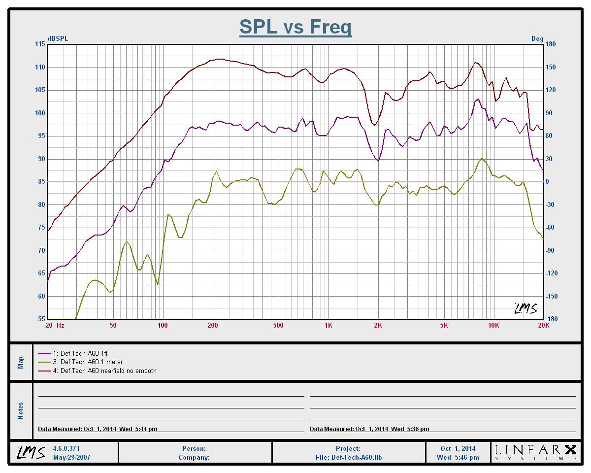

I attached some pics and also a nearfield frequency response measurement of the A60 module.

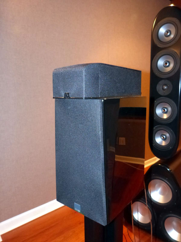

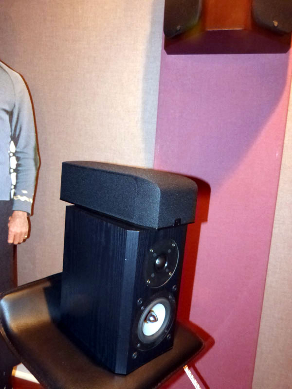

Those look like the SVS Ultra bookshelves and the RBH E-41B's. SO you're saying that if I were to get the Atmos modules I could have the same setup as the AH reference room?!?!?
Minus all the cool electronics and the massive Status speakers though.

The speaker on top is the Definitive Technology Atmos speakers
And, is that the RBH SX-61 bookshelf speakers being used for the demo?
I tried to use the most affordable speakers I have on hand to do this demo to represent what the average person buying a $2k receiver would use. The problem I am finding is that the sonic characteristics of the RBH and SVS speakers are so superior to the Def Tech A60 Atmos modules that they become a big limitation when turned on.
OK here is the setup:
  • Receiver: Denon AVR-X5200W
  • Blu-ray Player: Oppo BDP-105
  • Front Speakers: SVS Ultra Bookshelf
  • Center: Status Acoustics 8C
  • Rears: RBH 41-SE/B
  • Front/Rear Dolby Speakers: Definitive Technology A60s
  • Sub: Velodyne Minivee
The SVS Ultra bookshelf speakers blend really well with the RBH's. Yes the Status center is overkill, but what an anchor in this little system! The sub is a bit weak but I'm not testing bass b/c Atmos doesn't change that.
Right- the RBH 41-SE/B does have a phase plug on the woofer
