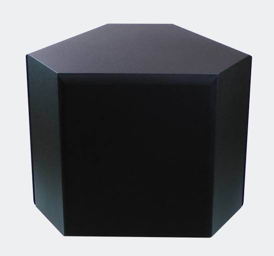

The Triax is the latest offering from fledgling subwoofer manufacturer Power Sound Audio, sporting a trio of 15" drivers in a tri-axial array and a 4,000W RMS / 8,000W Peak amplifier in a sealed enclosure. Currently priced at $2,799 (introductory) which is expected to rise to $3,299, the Triax is far from being inexpensive, though for the hardware you get, it appears to be a veritable bargain. The first release of Power Sound Audio's new Prism lineup, how does the imposing Triax stand up to a a quick inspection? Read on to find out.
Executive Overview
Unlimited Power!!! What other words could be used to describe such a subwoofer? In terms of raw specifications, one of the more pertinent items for a sealed subwoofer to consider is sheer displacement, as there are no ports here to augment output. Suffice it to say, the Triax is "well equipped", with a trio of 15" woofers each rated for a peak to peak excursion of 3". Compare this with the formidable XS30, which boasts a pair of 15" woofers with 2" of peak to peak excursion, and you'll note the Triax has more than double the driver displacement.
Displacement is critical of course, but without a capable amplifier to realize the potential, you're not going to get very far. However, this is unlikely to be a major concern for the Triax as it boasts a 4000W RMS class D amplifier. The partnering amplifier also has a couple of useful tricks, including a soft-start and long-term power limiter to reduce the odds that you'll trip a breaker in use. Naturally, the amplifier is also DSP optimized, and features two built in programs to help tailor response to your room.
So what does all this add up to? Power Sound Audio states that the Triax should deliver 2 meter CEA-2010 burst testing averages of 127.1dB in the 40-63Hz band and 116.1dB in the 20-31.5Hz band, which would give it twice the output of the extremely potent Paradigm Signature Sub 2. In no uncertain terms, there are very few subwoofers on the market today that could hope to touch this performance. This kind of power makes some of the most potent subs tested by Audioholics such as the Rythmik FV15HP and SVS PB13-Ultra, both Extreme Bassaholic rated, look like toys. That's pretty impressive any way you dice it.
Now all the power in the world is great (and it certainly appears to be on tap here), but it won't make a whit of difference if the subwoofer is an ugly black box that your wife vetoes. Power Sound Audio's previous designs haven't exactly been ugly, but they aren't exactly the most attractive designs on the market either. The Triax (and presumably by extension, the Prism line) is looking to change things a bit. The base finish appears to be a relatively ho-hum satin black texture, but for an additional $200, you do get the choice of four wood veneers which should spruce up the look nicely. Combined with the tri-axial layout, the Triax should be anything but an ugly black box.
Power Sound Audio seems to be raising the bar yet again. While the new Triax doesn't qualify as cheap at $2,799, it has the qualifications necessary to be considered one of the most powerful sealed subwoofers on the market today, and it achieves this while being accessibly priced. Moreover, unlike a lot of big value oriented subwoofers, the Triax is anything but an ordinary black box. The only question in my mind at this point is: what's next for Power Sound Audio?
So what do you guys think? Any bassoholics in heat right now? Should Josh Ricci review this puppy? If he does, who's going to help him wrestle 190 pounds of subwoofer?

Quick Specs
Driver: Proprietary 15” driver with dual 3" diameter voice coils, 25lb heavily vented motor, 3" peak to peak excursion, assembled in the USA
Amplifier: 4000W RMS (continuous), 8000W Peak (dynamic) with DSP, class-D topology, 120VAC only, built in USA
Enclosure: Sealed enclosure, Triaxial driver array, Made in the USA
Dimensions (D x W x H): 27.5” x 31” x 23.5”, Weight: 190lbs
CEA-2010 Ratings (2m ground plane): Ultra-low bass (20-31.5 Hz): 116.4dB
Low bass (40-63Hz): 127.1dB
