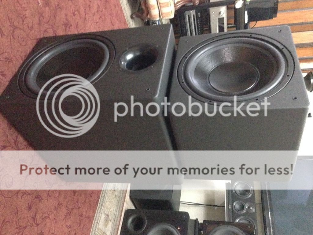

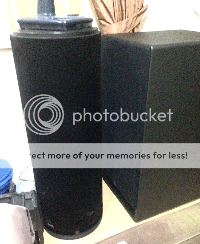

i couldn't escape the pull of a ported sub. went with the ported option. once i save enough, i'll get the dual sealed option to compare as well.
mike c
mike c
arrived november
headroom/output wise, the V3600 definitely has more than what I require
i have my PC13 5db hot, but i control my overall output by the master volume to keep the pc13 from bottoming in the grenade scene in WWZ.
with the V3600, i believe i'm at about 8 or 9db hot and ever increasing master volume ... until the wife came kicking down the door to tell me to stop.
the woofers barely move, though i'm not sure they are able to move much at all
midbass wise, there is "some" improvement over the PC13
but i'm not sure if i'm imagining that the PC13 + dual SB2000 has some advantage in the midbass or not.
i'm thinking there's still more to be had, but i'm limited to this one subwoofer location though.
