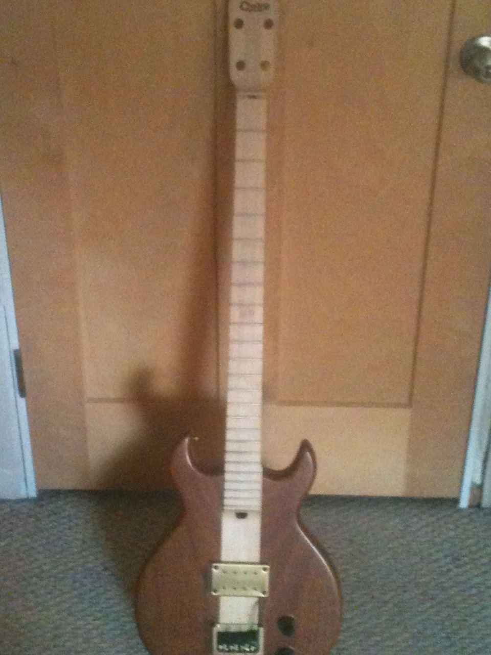

The finish is done and I used TruOil on the neck. Actually, I used that fast-dry poly and let it harden fully (AKA "ran out of time and had to let it sit for about a year"). I put green painter's tape along the frets so I could dress them and clean up the ends- when I was done, I peeled the tape off and a good amount of the poly came off with it. I believe I sanded it too finely, so it didn't have anything to grab onto- it doesn't soak in like some finishes, so I used NAPA carb cleaner to strip the poly. The non environmentally-friendly stuff removes all kinds of finishes and I found out about this as a paint stripper when I was working on boats and I needed to clean a flame arrester (marine version of an air cleaner, but if it backfires, it won't allow flame to pass through it), so I sprayed it on and watched the black paint crinkle immediately. It was Summer with high temperature & humidity- this stuff is so volatile that frost formed on the aluminum.
Once it was stripped, I decided to try lacquer, so I wiped on a few coats of dewaxed shellac and sprayed the lacquer. It looked good, but must have been an old can, because I left it for weeks and it never hardened. I have worked with nitro before and this stuff was completely different. Once that was stripped, I left it to off-gas whatever solvent was in the wood, until I couldn't smell anything from the wood. During that waiting time, I decided to try the Tru Oil and that s tuff is geat! Wipes on, excess wipes off, let it dry. go back the next day and add a few more coats after scuffing with mild ScotchBrite, let it dry. Day 3, Scuff with ScotchBrite and wipe with Naptha, then a few more coats. I think I did this for about 5 days before deciding that it had enough of a finish, so I let it sit for a couple of weeks before final sanding. I did this last step with mild ScotchBrite dipped in paste wax before wiping with a dry paper towel (the blue or white Shop Rags work great). The finish is thin, but it's made for gun stocks, so it's durable.
Not the best photo, but it shows the old hardware body with new bridge and neck.
