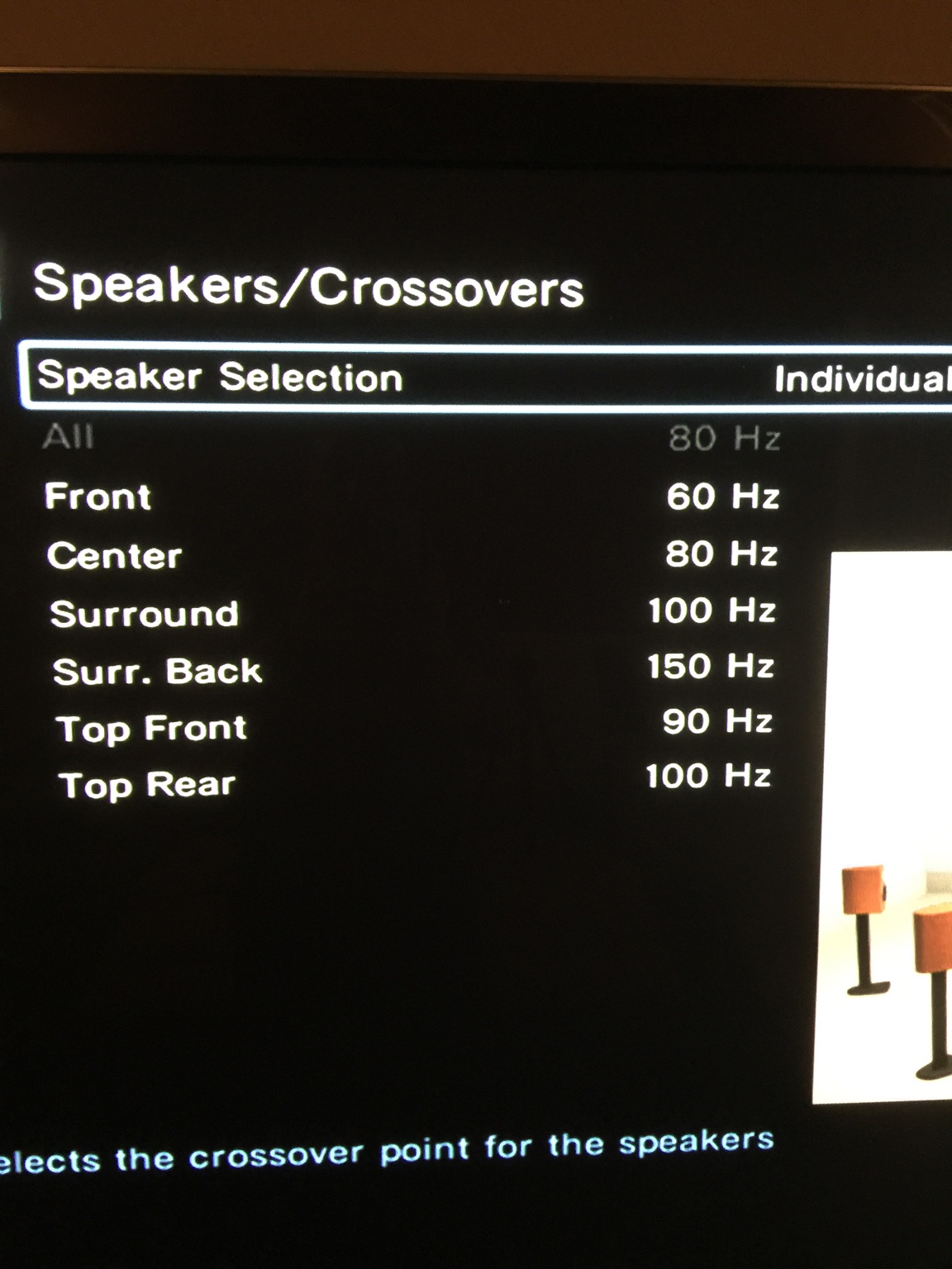

I re-ran Audyssey to double check what crossover settings it would give and here are the results (see photo).
What are your thoughts on this considering the speaker specs I gave at the beginning of this post and you suggestion of bumping them up?
1) The front and center settings look good to me. I am not surprised Audyssey put the fronts 20Hz lower, the tower cabinets are a lot bigger than the center speaker. I have found I prefer a bit lower setting on front towers, especially for 2-channel sources played back in a stereo or direct/pure direct format.
2) If I understand correctly, the surrounds and surround backs are the same type speaker, SUR 95T. IMHO these two settings should be closer than 100 and 150Hz.
- ?? Is there is a signicant placement difference that moght be causing an elevated surround bass response, such as corner loading?
- I would adjust the surround backs to 100Hz or 120 Hz. The 150Hz setting seems a bit high to me and I don't like to send frequencies inviting sub localization.
3) I assume your ceiling front and rear speakers are also the same type and are being used for ATMOS duty. I looked up M&K and liked what I read, silk dome tweeters are one of my favorites.
- ?? Your post cited M-5 speakers (small bookshelfs) or are they the IW-5 inwall/ceiling speakers?
In either case I would set these to the same 100Hz setting.
Hope that helps,
XEagleDriver

1. The L and R are basically the exact same speaker as the C but just in a tower form. Speaker diameters are exactly the same.
2. The surrounds are all exactly the same speaker. No difference in locations from side and back.
3. Yes ceilings are all the same as well M&K M5 bookshelf type, not in-wall.
Reading on crossovers on Audioholics they mention to not lower the crossover under the manufacture spec....which for the L/R is 80hz. So would 60hz be ok??
