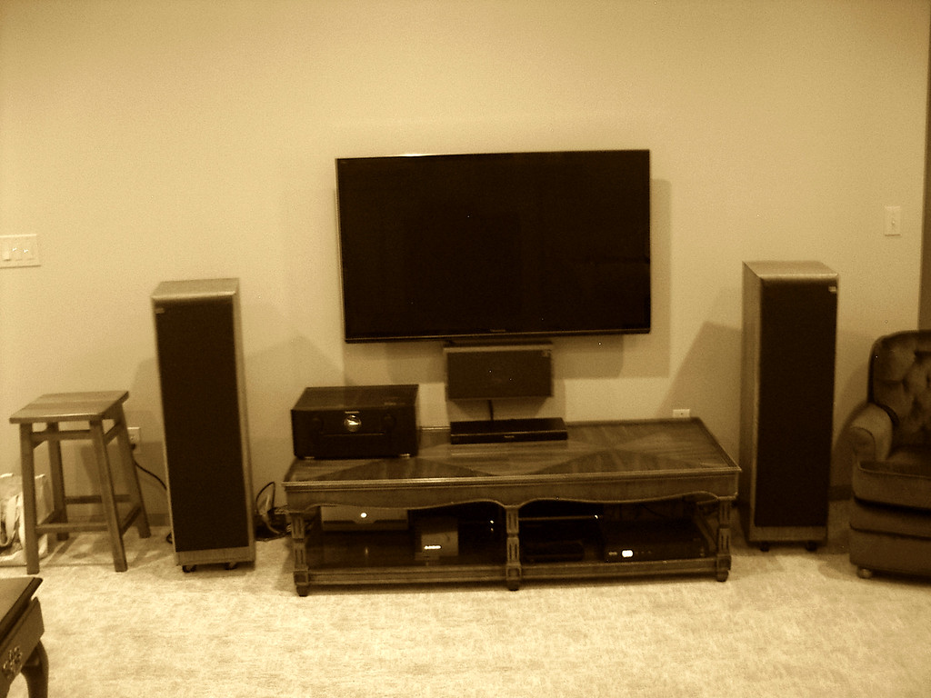

If your room is going to be like fireplace room in that picture, that is a nightmare scenario. Mounting the TV above the fireplace will be way too high to ever comfortably view it for more than 10 seconds, at least if you are not standing up. The built ins on the sides ... well, such a setup might be fine for watching the nightly news, but I wouldn't try to try to push it beyond that. Such a placement would only be good for casual viewing. I would not want to lose myself in a movie on a system like that, it would be so badly compromised. A 70" TV is too big to fit anywhere in there unobtrusively.
My advice is, if you really like movies or listening to music, turn one of the upstairs bedrooms into a dedicated media room or home theater room. Let the great room be for relaxing, socializing, etc. Don't clutter it with audio / video equipment.

Like Striker said, mantle TVs are too typically high. The issue is having to continually crane your neck looking upwards. However, this can be alleviated with enough distance from the screen. A 70” TV is pretty big, and 12 ft. is probably too close for a TV that size anyway. So you can “win-win” by sitting further back, maybe 17-18 ft, especially if you can get the fireplace and mantle lower like you said.
With those built-ins, your current floor-standing speakers probably won’t work, at least not aesthetically. You’ll probably want some bookshelf speakers that can sit in the built-in cabinetry. Probably want to go with a physically smaller center channel speaker as well. Subs will probably be best stacked in the far left hand corner
