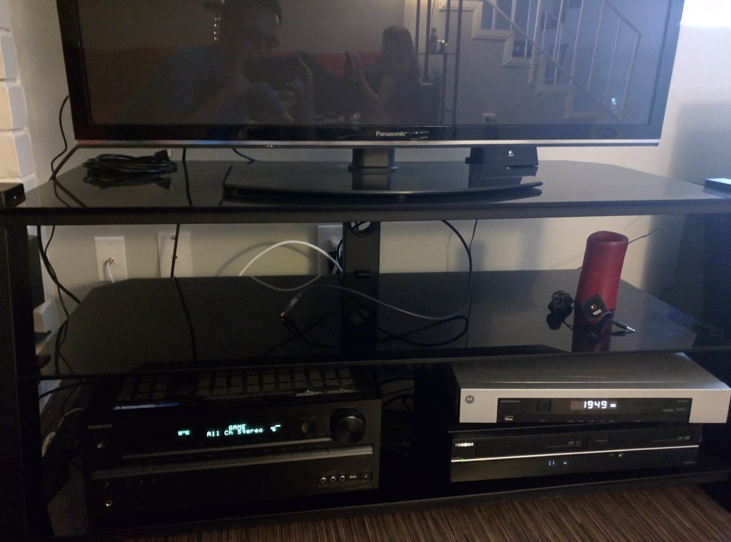

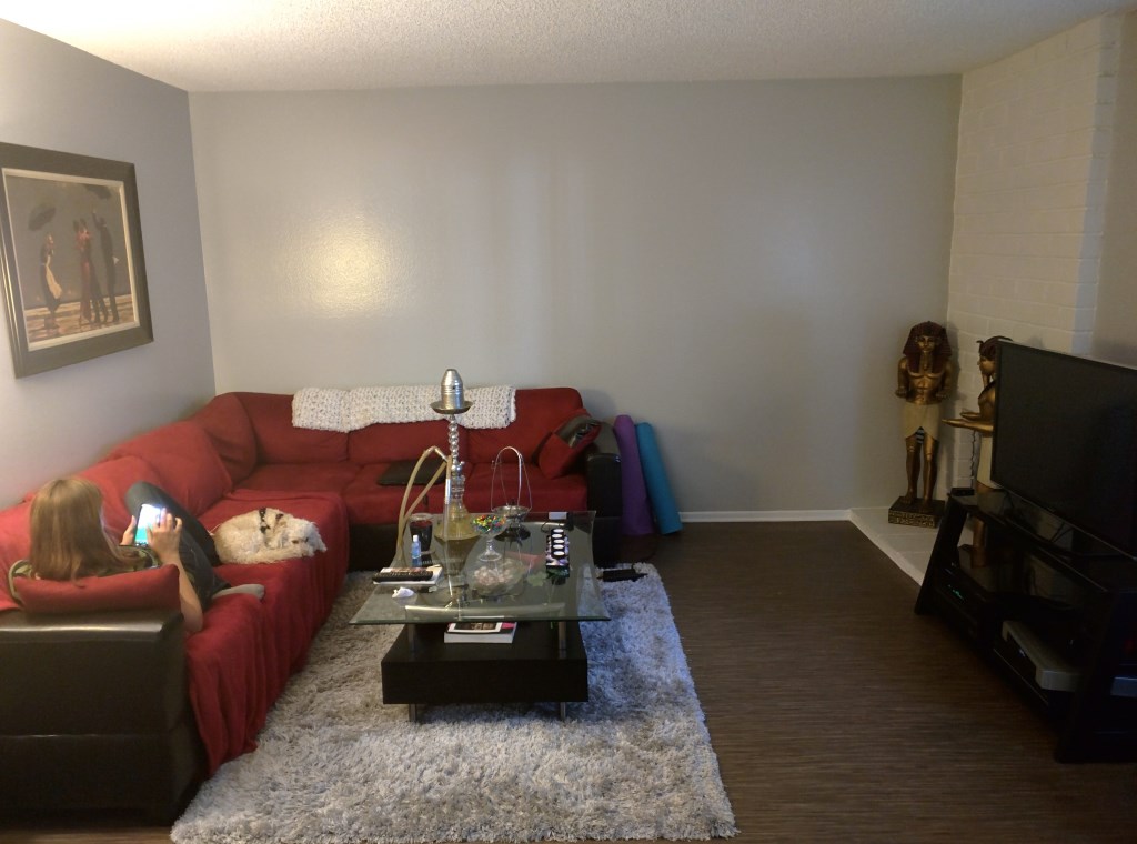

My living room is about 12x10 and has an open end to the dining/kitchen. Attached are pictures.
I've already got a subwoofer and receiver so I am on a budget of around 1500 for the remaining speakers.

As you can see by my attachments, my furniture isn't situated optimally for speakers so maybe some advice on placement would be great too!

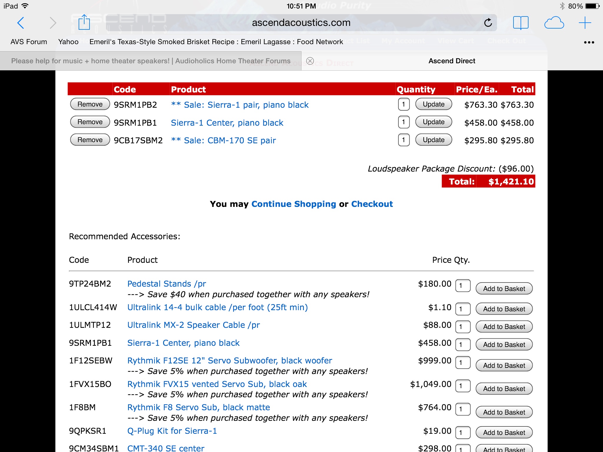

So I'm not sure what you're talking about for the CMT 340s being $1500 just for the LCR... I created a full surround package (not including subwoofer) of 5 speakers:
http://www.ascendacoustics.com/
using the system advisor....
CMT-340 SE front pr + CMT-340 SE center + CBM-170 SE rear pr
after discount this comes to about $1163.80

I'm not sure about the Sierra 1s. Spending about $500 more plus needing to purchase an amp might break my budget since I still need to buy accessories like speaker wire, bannana plugs, etc.
The Onkyo 509 will drive the Sierra 1 or CMT 340 just fine. For same amount of power delivered by the receiver, the CMT 340 will be louder.

If the living room is where you intend to go 7.1, in the current orientation, there isn't sufficient room for the rear speakers. Now if you rotate 90 degrees, so that TV faces the mirror, you may get away with it.
J
Jalal Soltani
Good point Agarwalro, I didn't intend on going 7.1 until after I moved out of my current apartment and into something more 7.1 friendly.
Even at 5.1 and at my current location with the fireplace being where it is, positioning these speakers are my next challenge. Center speaker would fit well under my tv on the tv stand but where to put the rest? One in front of the fireplace angled towards the couch (left)
one near the red vase angled towards the couch (right)
Or I could shift the TV Backwards on the stand and maybe put the CMT 340s in front and to the sides of it but then I think they'd be too close together...
Not even sure about the rears... seems like L sectionals in a corner are the worst for speaker placement!
Maybe right above the two corners of the couch against the wall with the singing butler painting?
Either way the center's tweeter needs to point to your ear level when seated. Ideally, it would be at the same height as the LR tweeters. If you put it in the empty shelf above the amp, use door stops to angle it up. I'd vote to put the TV on a riser and keep the center on the TV shelf. Something like this,
Whatever you do, the center should not be recessed. If at all possible, it should be in front of the TV stand, but, flush with the edge will do.
This might be too far.
This is definitely too close. Ideally, the distance between LR should equal their distance to your main seat (to form an equilateral triangle).
They will have to be right up against the back wall at the two ends of the couch. When you're seated, they should not be ahead of you.
